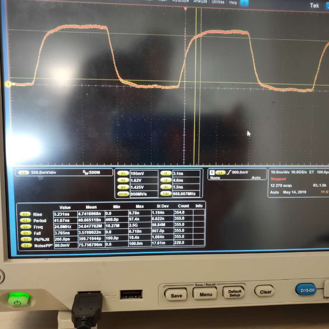

We are using DS90UB954-Q1 , we want to using system clock as refclk,could you check attachment can match 954 criteria of refclk?

Again, going by the scope shot the average/max jitter is above the limit. The measurement is showing ~400ps p-p jitter mean value which exceeds the datasheet limit.
