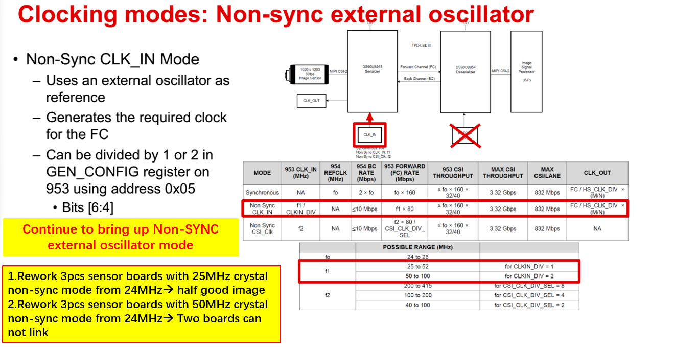

Hi Team,
one customer has following question and need your help.
We have use the ICDS90UB935/936 for Serdes solution, 935 connect to the OV sensor with MIPI interface, 936 connect to ISP.
We use the STP cable to connect the 935 and 936 the two boards.
Firstly we design the SYNC mode , but the two boards can not link.

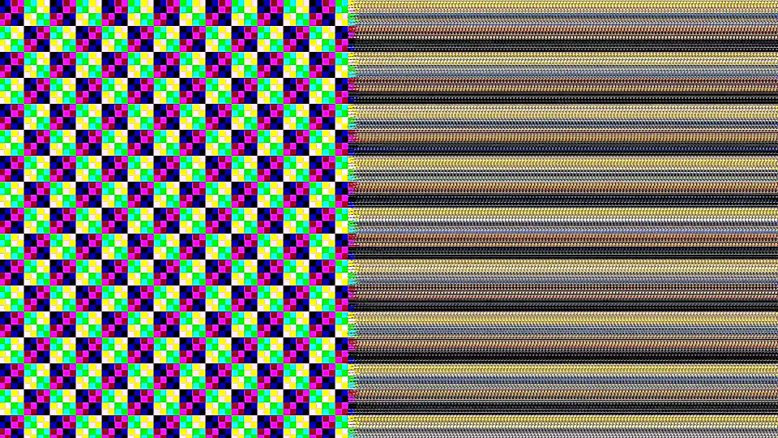

When we change to the non sync mode with the 25MHz clock for serializer 935, we see half good image from ISP side(deserializer 936 side.)
When we change the non synce mode with 50MHz clock, the two boards can not link any more.
We test the mipi signal from the two side, the serializer MIPI signal from OV cmos sensor seems OK, but the desiralizer MIPI signal on the ISP side is not right,
Seems only recovery half MIPI data signal.
The test pattern comes from OV cmos sensor.
Would you please give me any sugestions? It is very urgent.
