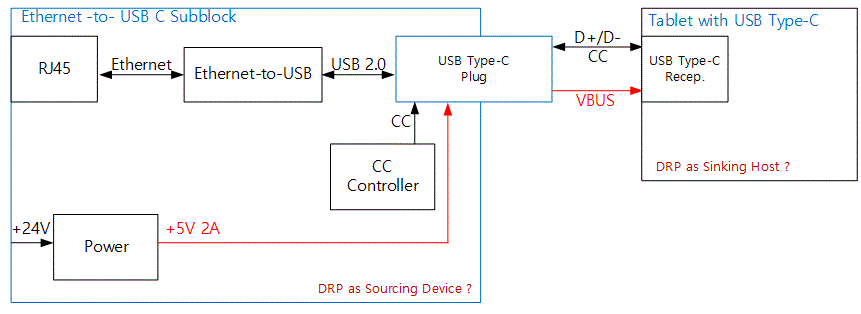

I would like to design a interface board.
I have question about below its sub-block.
I don't want to use programming like I2C, I just prefer to hardwired GPIOs for setting DRP Sourcing device mode like docking station without Hub IC.
Can I use CC Controller for TUSB320 or TUSB321 to below application?
If yes, where can I refer to schematic for below application?
Also do you have any idea for below application?
