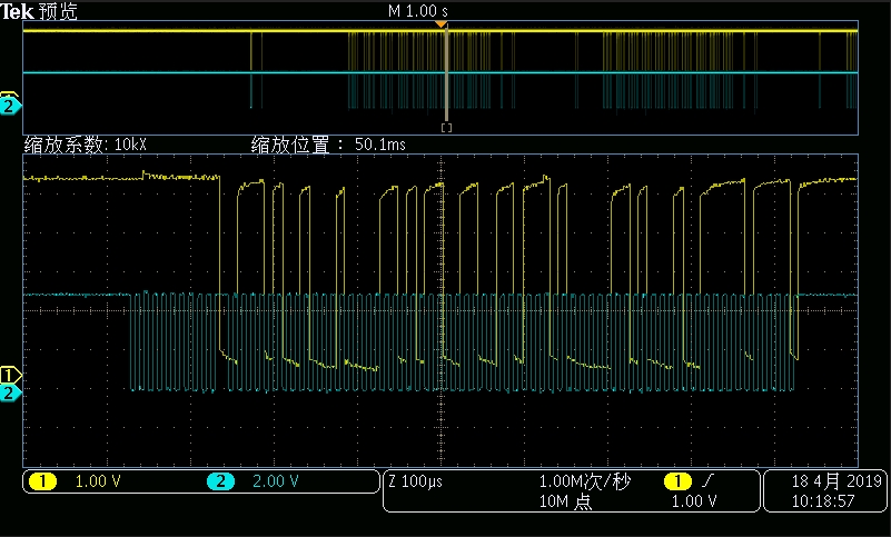

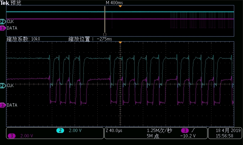

My customer is using TMDS181 in their new design and an issue has reported.
They use TMDS181 for HDMI out re-timer and found that the SCL_SNK is almost the same with SDA_SNK.
The waveform is shown below:
The second picture is SCL_CRC and SDA_SRC waveform.
  • Gabriel
    Please use the TMDS181 snoop configuration where the SDA/SCL from the source is connected directly to the SDA/SCL of the sink. The TMDS181 will need its SDA_SNK and SCL_SNK pins connected to this link in order to correctly configure the TMDS_CLOCK_RATIO_STATUS bit. This is shown in Figure 35 of the datasheet.

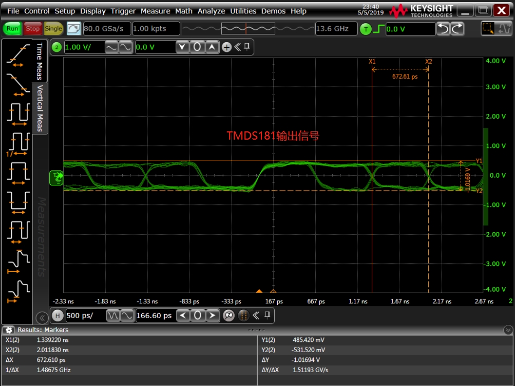

    Cutomer used it in TV as HDMI out re-timer so it should be source side application.
    Customer configure it in I2C mode and use default setting.
    The video source output 4K@60HZ signal to TMDS181 so it should be a signal up to 5.6Ghz.
    But they probe the output signal and found that it only have 1.5Ghz. And they have already probe the input signal and confirmed that the input signal is 5.6Ghz.
    Below is the wavefrom captured by customer.
    Are any configuration need to be done in 4K operation?
  • Gabriel
    Please have TX_TERM_CTL set to 0x11b (75ohm to 150ohm). Can they dump out the entire TMDS181 register, both page 0 and page 1(write 0x01b to address 0xFFh first)?

    For TX_Term_CTL setting do you mean we need to connect a 75ohm~150ohm resistor between this pin and ground?
  • Gabriel
    Since TMDS181 is in I2C control mode, the TX_TERM_CTL bit, not the pin must be set manually depending on the source. When the source is HDMI1.4, the TX_TERM_CTL bit must be set to 150-300ohm. When the source is HDMI2.0, the TX_TERM_CTL bit must be set to 75 to 150ohm.

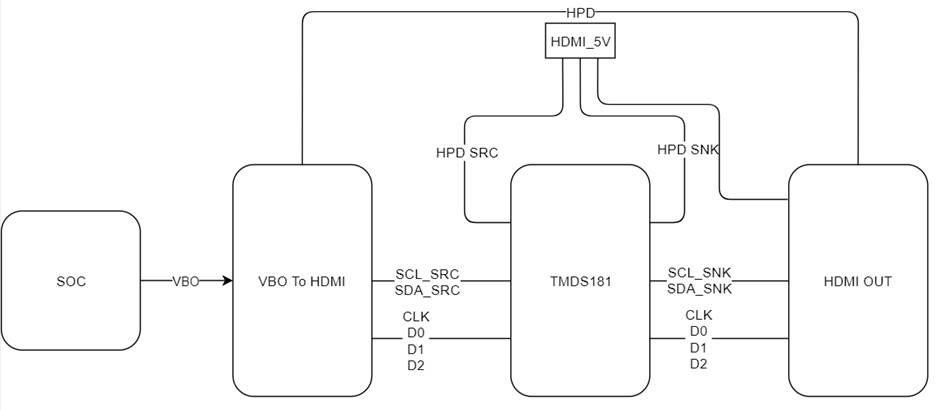

    Customer requirement:
    1. They don't want to do DDC communication.
    2. They want to output always output HDMI2.0 high-speed signal no matter what device plugin.
    As they don't want to do register initialization configuration again when a sink device plugin or plug out. So they plug both SNK/SRC HPD to HDMI5V.
    1. When the system is powered up without a monitor connection. The TMDS_CLOCK_RATIO_STATUS read back 1.
    2. When the system is powered up with a monitor connection. The TMDS_CLOCK_RATIO_STATUS read back 0.
    No matter with or without the monitor, customer system SOC won't output HDMI signal after TMDS181 power up. Until SOC receive a commend from user it will start output HDMI signal but TMDS181 didn't have output signal. Customer needs to disable SOC HDMI output and enable it again and repeat 3-4 time the TMDS181 will have possibility output normally.

  • Gabriel
    Is this a close or open design? Are they only going to have HDMI2.0 display connected to their system?
    Part of the DDC communication is to enable the display to communicate its supported display modes to the SOC. But a HDMI1.4 display will not work at HDMI2.0.

  • Hi David
    It's a close design.
    So want it outputs HDMI2.0 signal all the time. Could you help to give some comments on my previous questions?
  • Gabriel
    Assume the SOC is sending out the proper HDMI2.0 signal and clock, for TMDS181:
    You need to disable DDC training
    Set TMDS_CLK_RATIO bits to 1/40
    Set TX_TERM_CTL bits to 75 to 150ohm
    Slave address 0xA8 offset 0x20 is the SCDC register, not the TMDS181 register.
    Please refer to section 8.3.1 for OE implementation, have a pulldown capacitor is ok as long as they meet the power-up timing requirement as shown in Figure 1 and Table 6.9.
