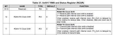

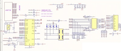

We penetrated our DP83822HF in new project in our customer, 4pcs/board. All DP83822HF are using RGMII interface and copper port. Debug is on-going, but now both link and communication failed, below is schematic and more information:

7. Tried to use RGMII RX/TX Clock shift as well(Tried all 00, 01, 10, 11), still can't work, communication failure;

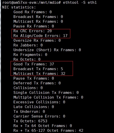

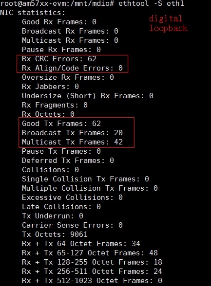

  • Hi Aniruddha,
    Sorry that can't reach you by phone, as it's urgent and now communication still failed and we tried loopback function, also failed! Today based on the test, got more information, showed as below:
    Now for loopback:
    1. MII loopback, failed, the register 0x01's bit 2, link status didn't change, still 0. So Mac can't send data to PHY;
    2. Digital loopback, the register 0x01's bit 2, link status change from 0 to 1, but we got below errors:
    3. Analog loopback, the register 0x01's bit 2, change from 0 to 1, but we also got below errors:
    Would you pls help further check these information together with the information I posted in last serial post, now debug is urgent, if this issue not resolved, we may lost this opportunity. Thanks for your support.
    Sulyn

  • Hi Sulyn,
    Apologies for the delayed reply. For the MAC side, please check with customer that RGMII traces are length matched. All RGMII TX data lines need to be matched to RGMII TX Clock. All RGMII RX Lines need to be length matched to RGMII RX clock. But the TX lines need not be length matched to RX Lines. Is there RGMII internal delay in AM5728? If yes, what is that delay? DP83822 has internal delay of 3.5ns. By default, RGMII TX delay is enabled and RGMII RX delay is disabled.
    For the Cable side, can you confirm that Bob Smith termination is implemented between magnetics and RJ-45. Magnetics center taps need to be directly pulled to AVDD voltage, on the schematics I see R1 and R9 as 10ohm resistors. Can you ask customer to replace 10ohm resistors with 0ohm. Also PHY is supplied with 'AVDD33' voltage rail but center tap is connected to '+3V3' voltage rail. Where is the '+3V3' voltage rail getting derived from?
