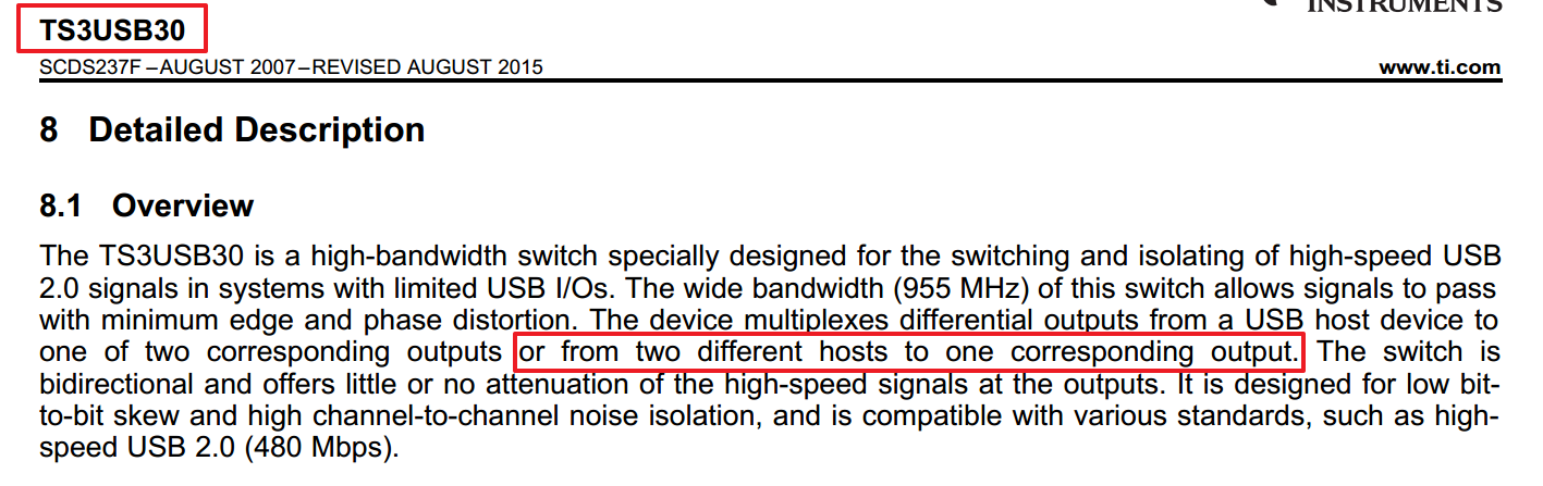

Hi team,
Can TS3USB221A connect to two hosts?
As I saw in TS3USB30 datasheet, it clearly written that The device multiplexes differential outputs from a USB host device to one of two corresponding outputs or from two different hosts to one corresponding output.
But TS3USB221A datasheet, it written The device multiplexes differential outputs from a USB host device to one of two corresponding outputs. And it doesn't mention whether can support from two different hosts to one corresponding output.
So can TS3USB221A connect to two hosts? Thanks a lot!
