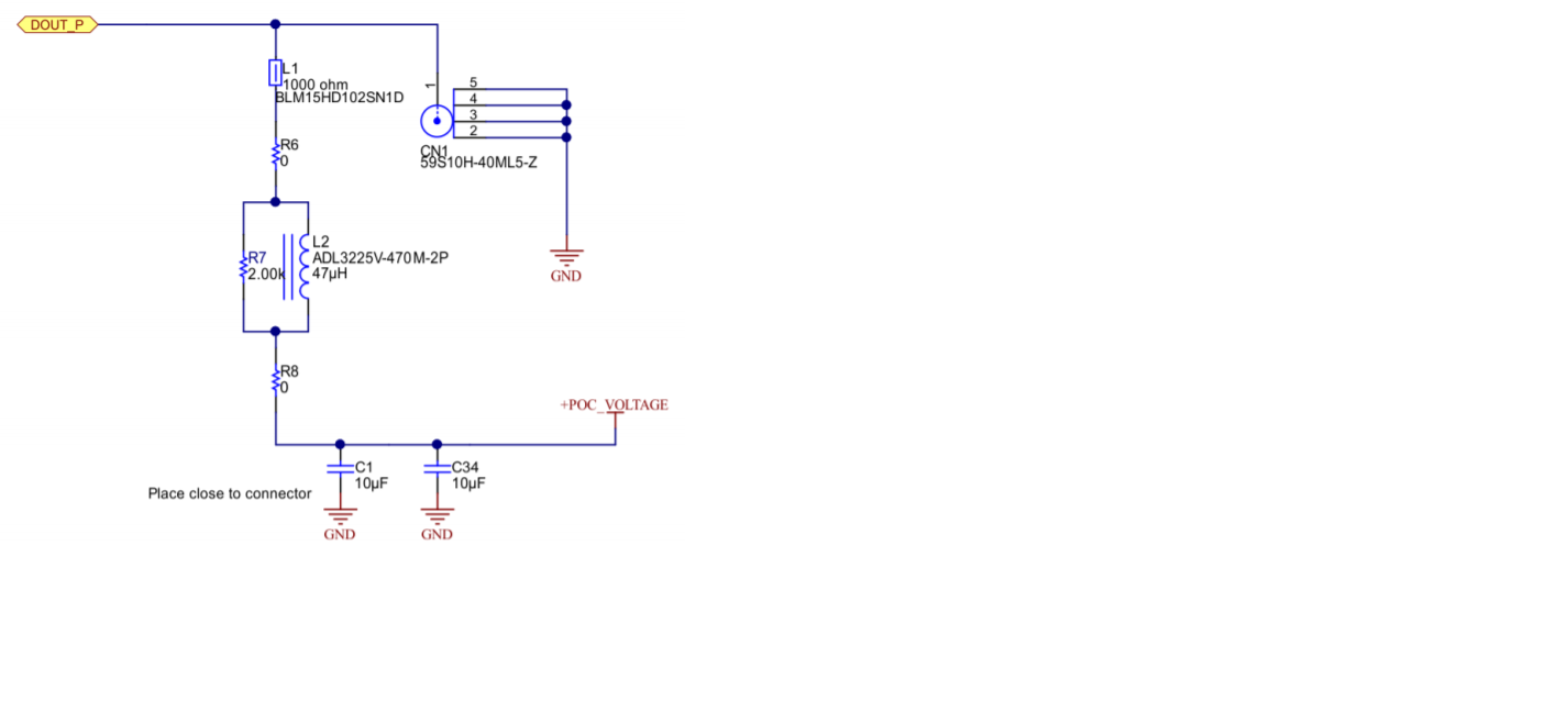

My customer would know DS90UB933A-Q1 POC circuit L2(47uF) have second source can be recommend by TI's qualified?
Please you kindly review & reply.
Thanks!
Steven
  • Hi Steven,
    We've only done our testing with this particular inductor and can't guarentee the performance of another. However, there are similar inductors but they have trade-offs. For example, LPC4045ATED470K is larger in size and only rated up to +85C but offers a lower DC resistance. SDR1307A-470K is another one but it is about 2-3 times larger.
    Another option might be to look at the TI Design of the 933, which offers a slightly different network and inductors. All the information is provided on the page below.
