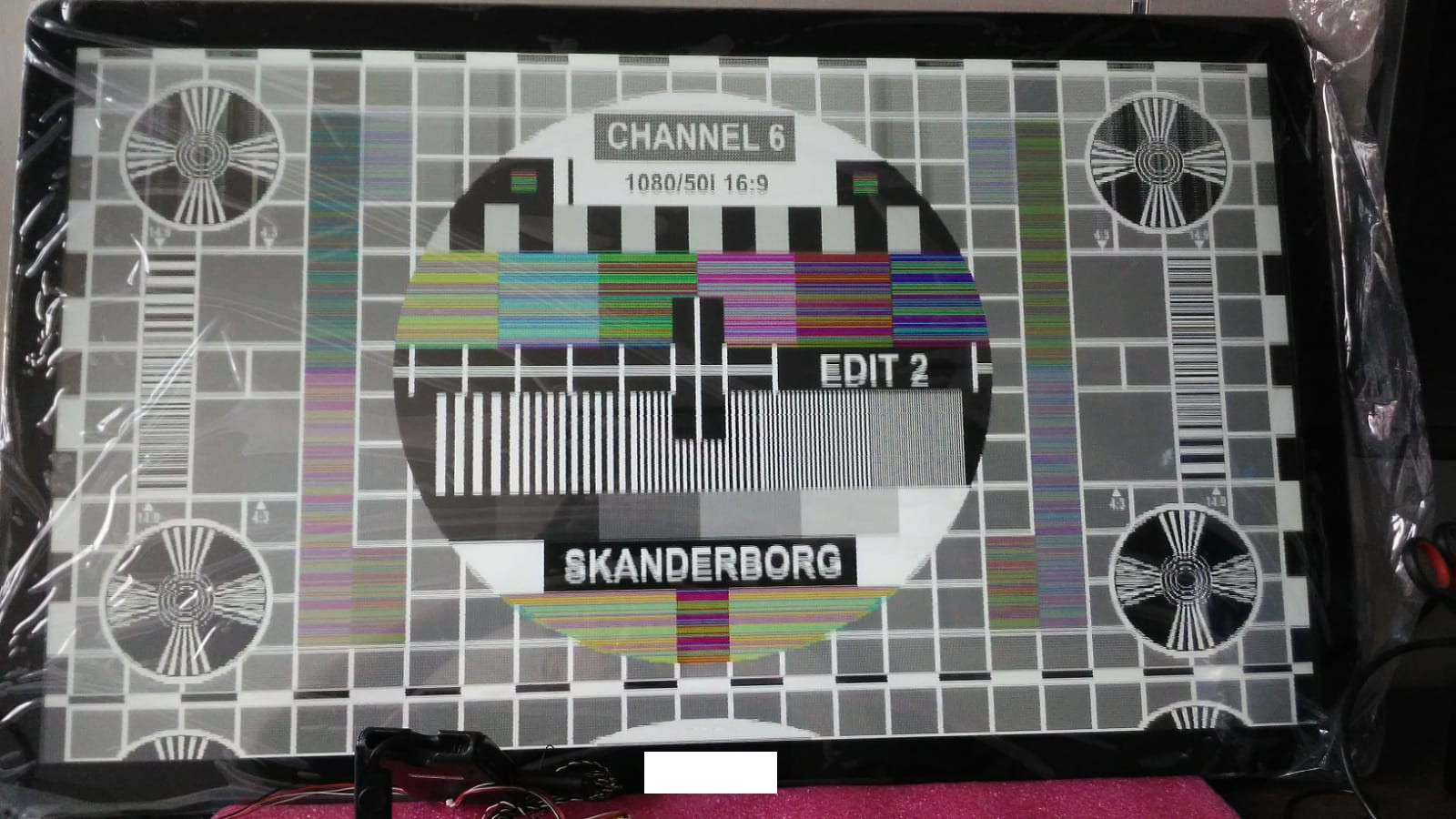

    We got the display working but facing problem related to timing (attaching the image of the present display)  I would like to know the mathematical relation between the CHA_SYNC_DELAY, CHA_HSYNC_PULSE_WIDTH  & CHA_HOR_BACK_PORCH.
    Could you please provide this information?
    Values currently used is as given below.
    Our display is dual LVDS display 1920 * 1080.
    Porch settings: HBP& HFP: 130 pixels , HSW: 20 pixels , VSW: 5 lines, VBP: 20 lines , VFP: 20 lines
    Pixel clock frequency = (1920+20+130+130) * (1080+5+20+20)*60Hz= 148.5Mhz
    DSI CLK is 445.5Mhz, 4 lines. LVDS clock for each LVDS o/p channel is 148.5Mhz/2 = 74.25Mhz.
    In my case not able to increase the value of the register 0x2C, CHA_HSYNC_PULSE_WIDTH to 20 which is the value required for my display (High lighted in yellow)

  • Please share you settings using the DSI-Tuner. You can either attach the .dsi file or screenshots of each window. You can also find line time equations in number 8 of this document: www.ti.com/.../slla356.pdf
    I.K.
    Attaching the .dsi file, could you pls check it. Also referred the pdf link you shared , but it doesn't says the about the CHA_SYNC_DELAY. What I would like to know is whether any conditions like CHA_SYNC_DELAY  should be less than CHA_HSYNC_PULSE_WIDTH + CHA_HORIZONTAL_BACK_PORCH?
      DSI Settings.zip
  • Hi Bijesh,
    Why are you not able to increase CHA_HSYNC_PULSE_WIDTH to 20? The DSI84 has no such limitation. Also, you should just keep 0x28 (CHA_SYNC_DELAY_LOW) as 0x21 and 0x29 (CHA_SYNC_DELAY_HIGH) as 0x00, as the DSI-Tuner recommends.
    Additionally, it is the line time you should be concerned about, since the DSI84 does not realign timing between the DSI side and the LVDS side. From your DSI-Tuner settings, you have a line time mismatch.
    Please try with the attached .dsi file and txt file with updated settings. Make sure that your DSI source is actually outputting the blanking parameters and correct DSI CLK frequency.

    The PLL_EN bit and SOFT_RESET bit are not set as they need to be set per the recommended sequence defined in the datasheet
    https://e2e.ti.com/cfs-file/__key/communityserver-discussions-components-files/138/Bijesh.dsi
    Also, I noticed that you selected Data Enable Polarity as negative. Please double check that this is the correct polarity, as most displays I have seen have this polarity as positive. Additionally, note that the DSI-Tuner has a minor bug where the Data Enable Polarity is stuck as positive whenever you generate the CSR list. You'll have to change the bit manually after generating the settings to ensure the polarity is negative.
    The best practice for using this device is to configure the settings with the DSI-Tuner, ensure the line time matches between the DSI side and LVDS side, and generate and use the settings. Here is a short tutorial: https://training.ti.com/configuring-sn65dsi8x-single-channel-dsi-dual-link-lvds-operation
    I.K.
  • Closing as resolved over email. Root cause was incorrect resolution setting from processor.
