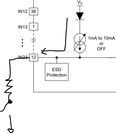

Hi Youngsu,
I would like to discuss with you what are the scenarios that the "malfunction" you are concerned with, due to reverse current leakage through the blocking diode.
For normal operation of MSDI:
From the minimum Vs requirement in datasheet, the Vs will need to be at least 4.5V for proper detection.
For example, if you connect the INx pin to ground-connected switches and set the register configuration and Vs voltage correctly, the current flow direction is as indicated in the arrow in below graph, so the TIC10024-Q1 would properly detect the switch status.

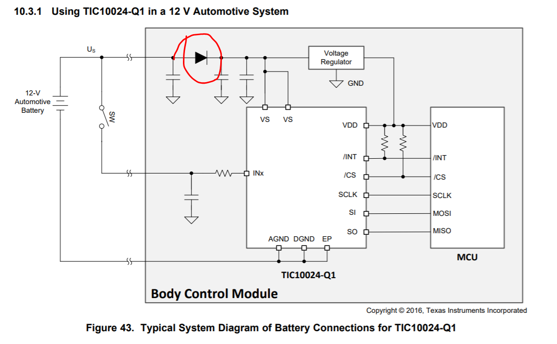

For transient/over voltage events:
If you are concerned with transient of the battery and over voltage events such as cranking and load dump conditions, care must be taken when connecting the battery directly to the device on the VS supply pin (through a reverse-blocking diode) or the input (INX) pins. Below is an system example in section 10.3 of TIC10024-Q1 datasheet.

Dear Helen,
Thank you for answer.
Let me ask you one more question.
I understand the voltage drop across the Foward direction.
What I will check is the leakage current value that can flow in the reverse direction at OFF.
Is this possible?
