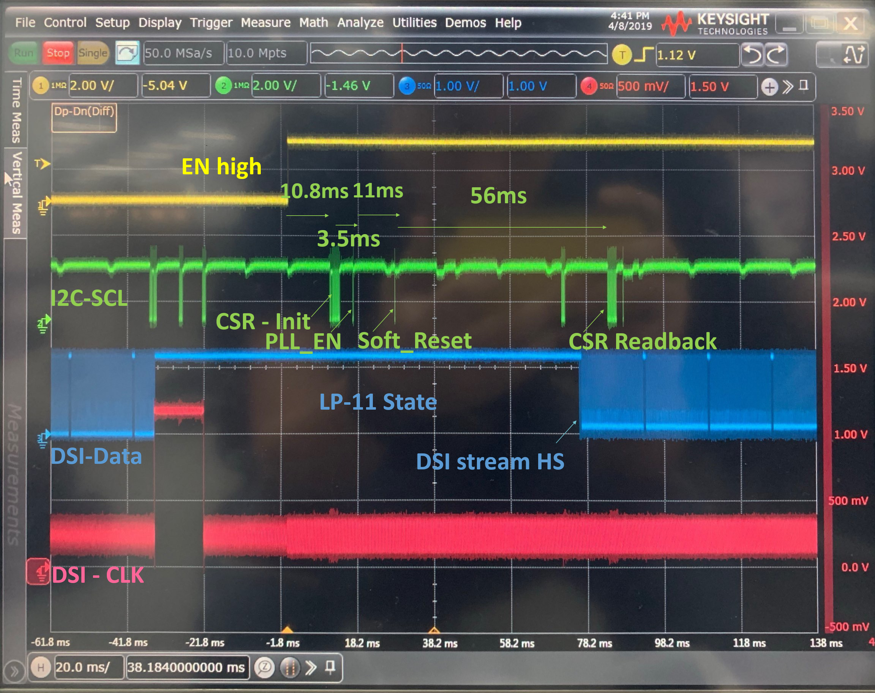

  • Hi Jepson,
    Please see my feedback below:
    1. Ensure that you are following the initialization sequence on page 15 of the datasheet. If this sequence is not implemented correctly then you will see abnormalities with the display. On an oscilloscope the sequence looks like:
    2. If you are still seeing issues after verifying the above, please provide the following:
    You can email these to me at i-anyiam@ti.com if you do not want to share them here.
