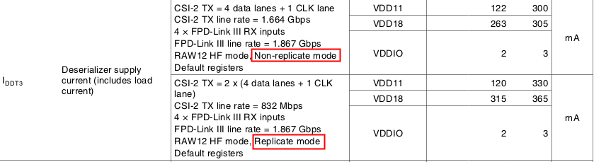

    I have some question in DS90UB960Q1 configuration about 4-way camera.
1. This is HUB, connected to four-way camera video, it can show that there is no switching relationship at the same time, right?
2. Display four different pictures at the same time, using non-repetitive mode or repetitive mode?
thanks.
  • Hi Yishuan,
    Refer to my answers below in red:
    1. This is HUB, connected to four-way camera video, it can show that there is no switching relationship at the same time, right? Yes, you can show all four cameras at the same time. We have two CSI output ports on the DS90UB960. Each port can aggregate up to 4 cameras. Please refer to the system examples in the datasheet for typical applications.
    2. Display four different pictures at the same time, using non-repetitive mode or repetitive mode? Replicate mode means that the output from CSI port 0 is copied and output onto CSI port 1. In other words, CSI port 0 and CSI port 1 output the same data. This is not needed if you don't need replicated output.
