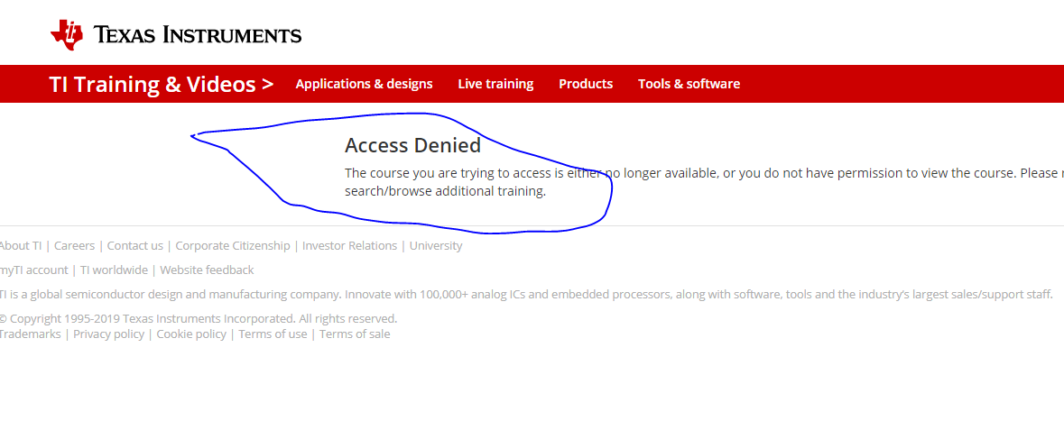

  • Dilson,
    I have never seen this issue before. Can you post a snapshot of the error?
    Casey
  • Hi Casey,
    Please find attach.
  • Hello Dilson,
    I have never seen this error before and the page is working fine for me. Can you please submit a ticket to central support here?
    ticsc.service-now.com/.../
    Casey

  • Hello Dilson,
    I have an open thread going with our web team actually on your account. They found that the issue is due to your account permissions and I'm trying to sort why your account doesn't have the required permissions.
