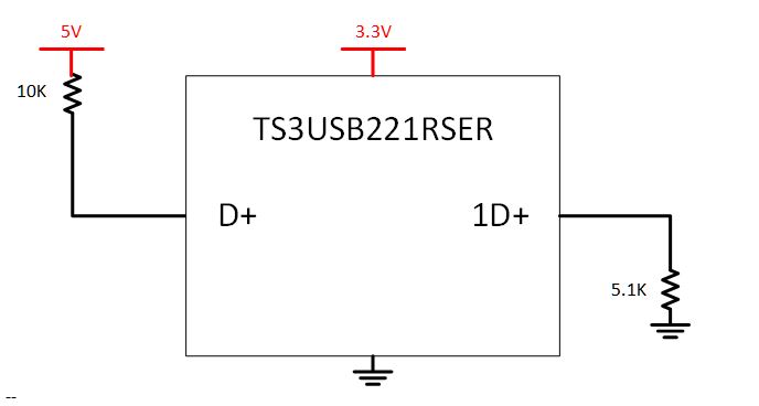

From my customer...
For one of the uses, I am switching resistors in and out of Type-C CC lines, to create different scenarios for the device I am connected to.  I am supplying the TS3USB221RSER with 3.3V, but there are cases where 5V may be applied to the IO.  The device says this is okay, but what happens in this case?
Take the circuit below for a specific question.  What will the voltage be at D+ and 1D+ in this case, assuming the switch is enabled and D+ is connected to 1D+?
