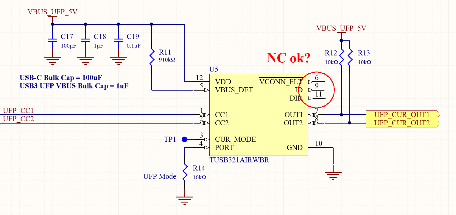

Below is the schematic of my TUSB321AI design. I wanted to have someone review it and also let me know if I can NC the VCONN_FAULT, ID and DIR pins when using the device in UFP mode?

Hi Malik,
Thanks for confirming the NC pins.
As for VBUS, this is on a UFP so VBUS is being input from a power source (i.e. AC adapter) so shouldn't it be available as soon as the port is connected? I was told this was OK in my post here: https://e2e.ti.com/support/interface/f/138/t/797707
Let me know.
