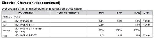

Hi
I have a question regarding the electrical specification of the MDI (media dependent interface) of the DP83822IF.
I assume that VOD is the differential output swing of TD, the signals going from the PHY to the SFP (FX mode).
What voltage swing is needed at the input to the PHY (RD)?
