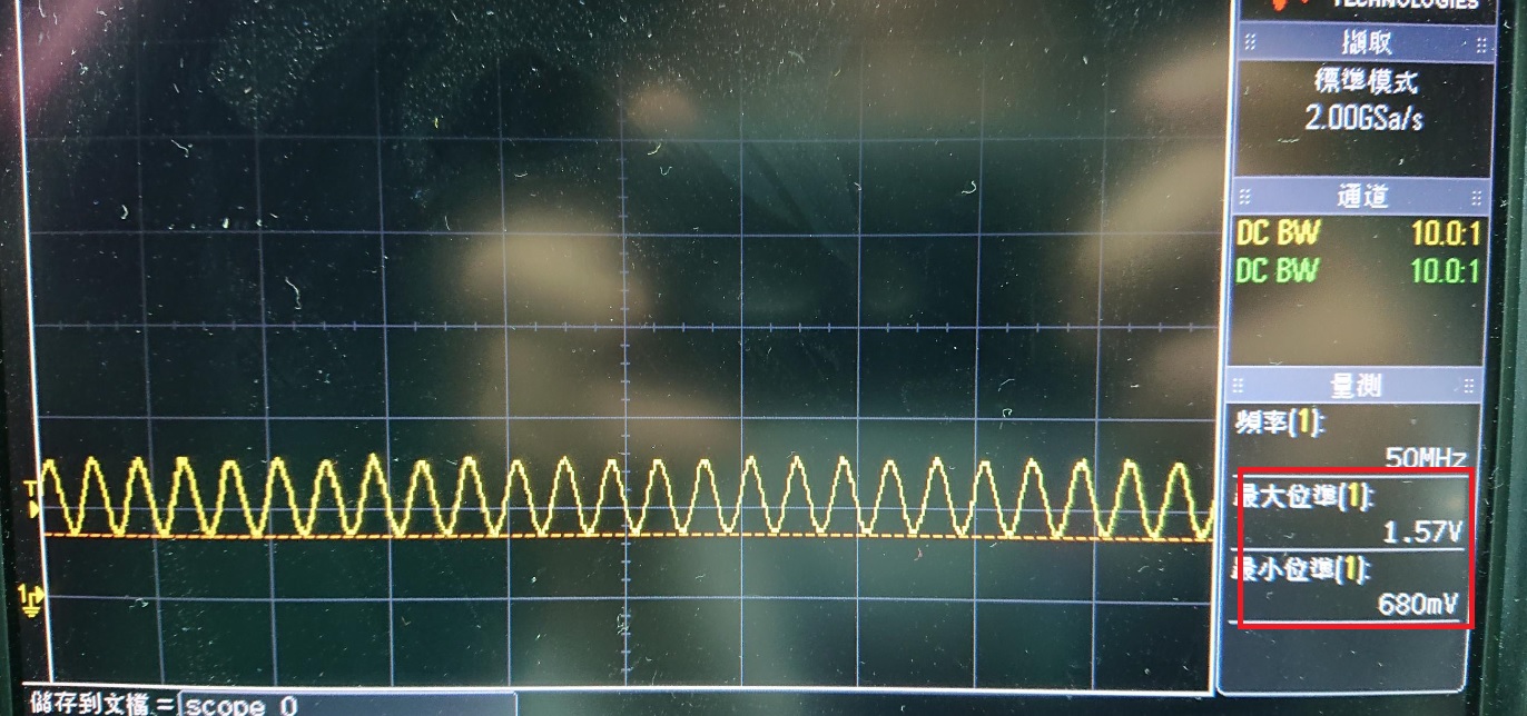

2. We use DP83825 EVM (default master mode) could be detected with Ethernet switch ,but if we change to set slave mode (J16) and provide a 50MHz from external clock gen ,the EVM can't be detected by Ethernet switch ,May I know the slave setting guide of DP83825EVM ?
3.I think IPCAM application need to set DP83825 to Slave mode ? is it correct ?
4.If I use slave mode ,how could I test EVM with Ethernet switch ,have anything need to config in DP83825? (reverse loopback or something else?)
5.if our VDDIO is 3.3V ,could you help to check voltage level as below is correct or not (Maxim 1.57V)
