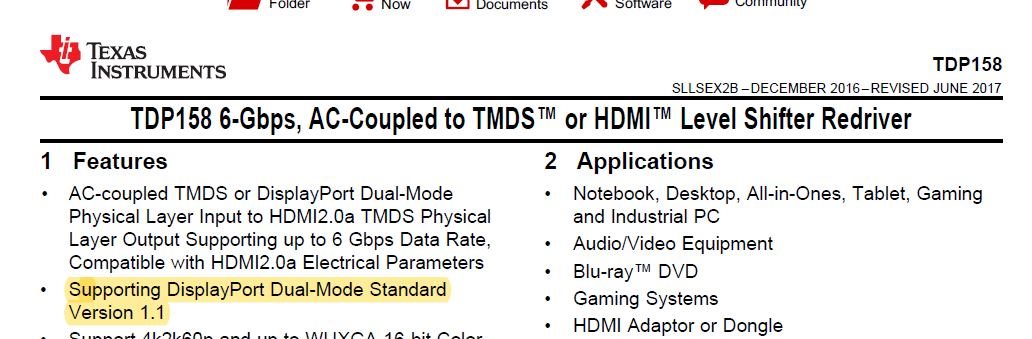

My customer took our TDP158EVM to test. It can have video, but no sound. Below is their configuration.
PCH with DDC MUX  will output DP++ signal. And they connect this signal to TPD158 EVM (J2) by DP to DP cable. Then they connect TPD158 EVM (J4) to monitor by HDMI to HDMI cable. This configuration is no sound.
[PCH (DDC ouput DP++) --> MUX--> DP to DP cable --> TPD158 EVM (J2) -->TPD158 EVM (J4) --> HDMI to HDMI cable --> monitor]
But if they use DP to HDMI passive cable to connect PCH and monitor. It can have video and sound.
So I would like to know is there any setting of TDP158 that we should change to support DP++ to HDMI? Thank you.
