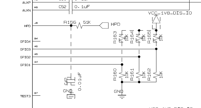

Hello Team,
SN65DSI86 is used as the transceiver from MIPI DSI to eDP.
The user is implementing driver code based on the linked source.
https://github.com/torvalds/linux/blob/master/drivers/gpu/drm/bridge/ti-sn65dsi86.c
I2C access is okay, but it cannot get the information from panel.
Please help to solve the following issue.
We are trying to register ti-sn65dsi86 (mipi DSI to eDP bridge) driver in i.MX8QXP.
As far as I understand, following shall be the link of the nodes in the DTSI:
MIPI_DSI1 -> MIPI_DSI_BRIDGE1 -> eDP_BRIDGE > PANEL
To do so we have added the driver and done modifications in the DTSI (please find attached file). Please note that the customer uses the eDP bridge on i2c0_csi0 pad group and not the default i2c0_mipi_lvds0 for MIPI DSI display configuration and pinctrl changes were similarly done.
We are able to probe the I2C slave device (edp bridge) at 0x2c, but it fails to find a DRM Panel. We are trying to display on HDMI monitor of 1920x1080 resolution and used a panel (from panel-simple.c) similar to this.
We also have a query on how to register the drm_dp_aux_register for eDP bridge. We have added the i2c-bus node in the edp-bridge in dtsi to register the sub device of i2c. Is this the correct way to do it?

Please help us know if I'm missing some crucial settings.
