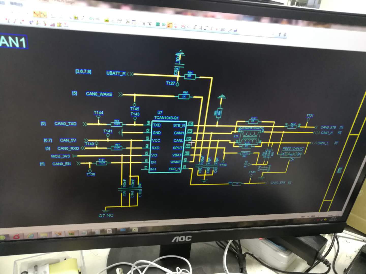

        I used TCAN1043 to replace TJA1043,used nfault pin to wake up MCU.
1, Do you help us check that can use nfault pin to wave up MCU in standby mode?

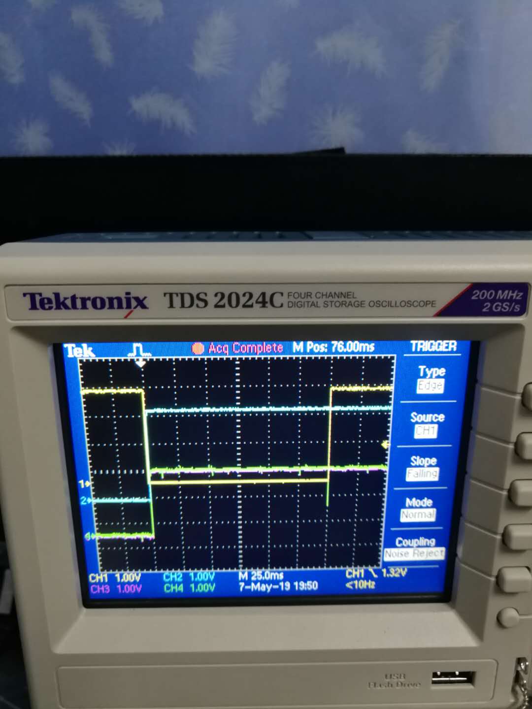

2, I used nfault  pin to wave up MCU find below problem

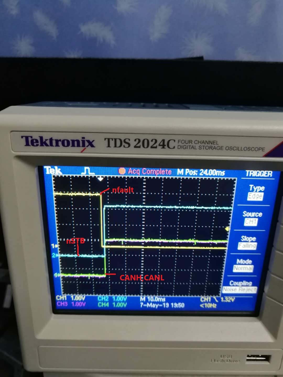

When MCU sends NSTB low voltage, CAN in standby mode . CANH/L has no information, nfault will cause an error low votalge  to wave up MCU, find this problem not in every time.
  • This phenomenon has occurred in several machines
  • Test condition:Vbat=6V, at room temperature
    • The test waveform and sch is as follows:
    • 3,
      • Could you please help us confirm the possible cause? the NXP TJA1043 no find this problem with nfault pin to wave up mcu.

    This could happen if the WAKE line toggles. A change of state on WAKE will result in a NFAULT going low while the device is in standby mode, and this low level does not clear immediately when entering normal mode. (If the wake-up request came from the CAN bus, NFAULT would clear immediately. This feature allows the user to distinguish the source of the wake-up request.) Four recessive-to-dominant edges on the TXD line should clear the fault indication.

    CH1:nfault
    CH2:nSTB
    CH3/4: CANH/L

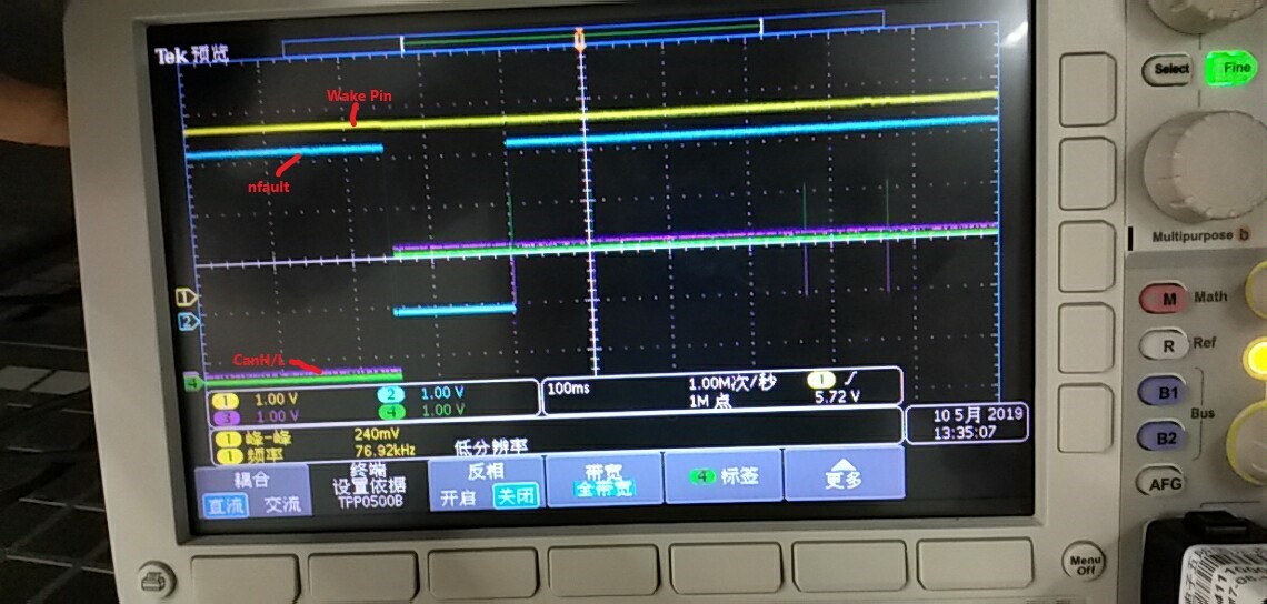

    Thanks for your reply,then I test the Wake pin, no find some noise on it when in sleep mode.test picture as below.
    Whether there are other possibilities can cause nfault to low voltage to wake up mcu when in sleep mode.
    thanks!

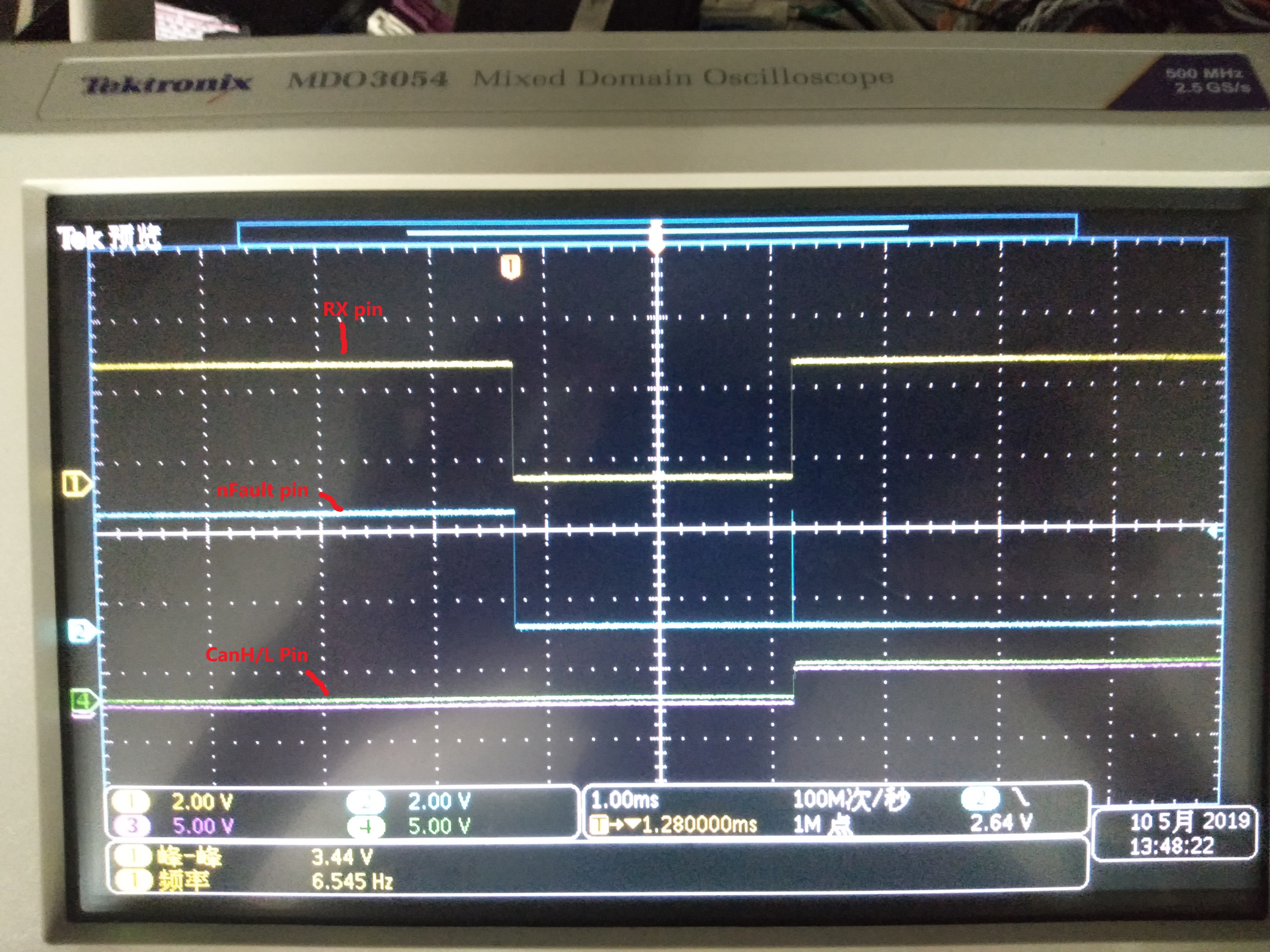

    Add a message,The RX pin has been drop out at the same time,as below
  • Jimmy,
    Both NFAULT and RXD will go low in standby mode when a wake-up request is received. The RXD line will go high when the part transitions to normal mode (as long as the CAN bus is recessive). The NFAULT line will go high along with it if the wake-up request came from the CAN bus. If it came from the WAKE pin, though, then NFAULT will stay low until TXD toggles.
    In your image, the WAKE line looks to be at about 3.5 V. This is between its high-level and low-level input thresholds. Can you please pull it either to GND or VSUP so that it is at a defined logic state (high or low - either one is OK)?
    Does this behavior only occur at VSUP = 6 V?
    Does NFAULT de-assert after the TXD line toggles? (I would expect four falling edges to clear NFAULT.)
    Max
