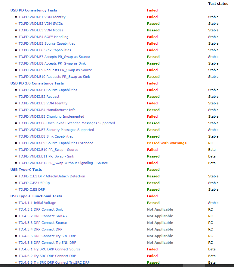

  • Hi Scott,
            I attach some our PD3.0 test result.
            The following is TPS65987EVM test result. The failure is mainly concentrate on USB PD consistency test / USB PD3.0 consistency test. I know some failure comes due to our VIF is not fully correct. So please provide an available VIF for PD3.0 test
    1. This setup will be fine in compliance as long as your .pjt project is correct for your system and settings are matching in VIF.
    3. We can help resolve the failures. You will have to correct the VIF to match your product. Let's only look at tests marked Stable. For each test you want to consider, I will need the actual failure message from the Test Report. Can you attached your current .pjt file?

  • I cannot update the myself VIF. Here are some initial comments:
    TD.PD.VNDI.E1 VDM Identity
    ->Update VIF BCD to 0x710
    TD.PD.VNDI.E2 VDM SVID
    ->I do not have the .pjt file to check this failure. Ensure the VIF SVIDs matches the pjt
    ->Same issue for .E3
    TD.PD.VNDI.E5
     VIF sets Accept PR_swap to yes. Ensure this is desired and that the .pjt has both accept pr_swap options as selected
    TD.PD.VNDI.E7 and E9
     Looks like a tester issue. Rerun
    TD.PD.VNDI3.E1
    TD.PD.VNDI3.E10
     Related to E5 above. I think .pjt is set not to accept PR swaps. This is okay if you set VIF setting Accept PR_swap to NO
    TD.PD.VNDI3.E12
     Known issue with DH patch 5. Test is beta status and will not be run.
    TD.4.6.x series
     These tests are Ellisys beta status
    TD4.8.1
     Is Audio accessory mode enabled and desired?
    TD4.8.3
     Does this result reproduce? Scope traces of CC and VBUS may help us understand
    TD4.9.2
     Please double check that pjt settings for PR, DR, and Vconn swap are correct for the device and they match the VIF
    TD4.10.x
     Does this device enumerate as a host and device? The VIF is set as yes and the tester expects it to respond
    There are a block of failed tests starting at TD.PD.SRC.E11 these look like either tester failures or device failures. Please double check each and retest.
    Some general comments
    You have
    Modal_Operation_Supported_SOP: YES
    Does this device support alternate modes?
    Data_Capable_As_USB_Host_SOP: YES
    Data_Capable_As_USB_Device_SOP: YES
    Is this device capable of enumerating as a host and device?
    Please check these and retest.
