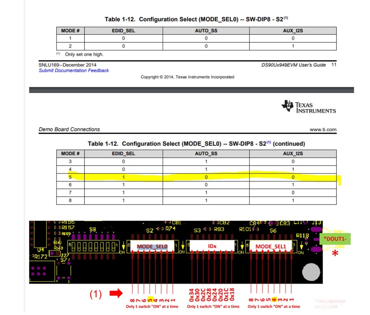

    Need TI help to clarify why the burned EDID table chaged after read from EEPROM through evm 949.
    Note:
    If the EEPROM value is 1280x720 resolution, the EDID value could read from EEPROM normally.
    Why:
    Need to use evm 948+949 to project video to 12.3 inch panel via HDMI cable.
    What:
    Need to store Panel EDID in EEPROM. EDID resolution is 1920x720. EDID table could refer to attached zip file (Unzip pw: fit)
    How:
    1. Burn EDID table in a 256 bytes EEPROM and then mount on evm 949.
    2. Update the evm 949 setting to use external EEPROM instead of internal SDRAM. (Refer to 1.jpg)
    3. Power on evm 948+949 and hdmi connect to 12.3 inch panel and PC.
    Expected Result:
    The video could ouput to panel due to corresponding EDID table 1920x720. (Refer to 2.jpg)
    Actural Result:
    The video could not ouput to panel due to EDID table unsync.
    Refer to our log data, the EDID table updated to 1280x720 resolution. (Refer to 3.jpg).

  • Also I would suggest trying to strap MODE_SEL1 for internal HDMI control, so set MODE_SEL1 switch to "2"
    Casey
