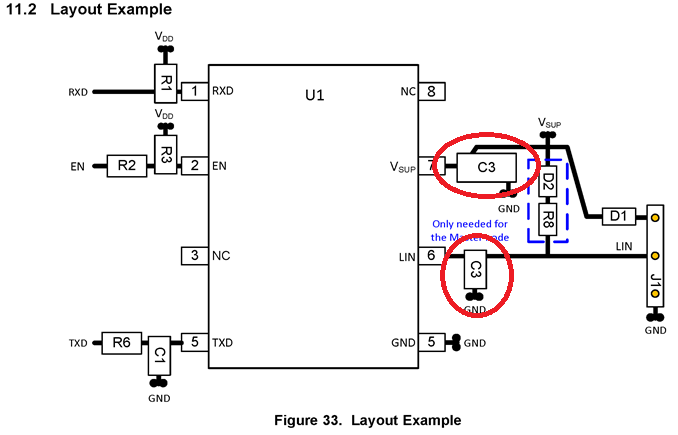

Looking at "Figure 33. Layout Example" on page 27 of the datasheet, there are two C3 of capacitors.
It seems to be a typo, and either one should be C2.
Which one is C2?
Could you teach me the correct part numbers?
If possible, we hope that this part will be revised together when there is a revision of another part.

    Since there is no other reference to C2 in the datasheet, it's irrelevant which one is labeled as such, but you are right in that it needs to be corrected. Let's call the capacitor on VSUP C2, the values should be:
    C2 = 100nF
    C3 = 220pF
