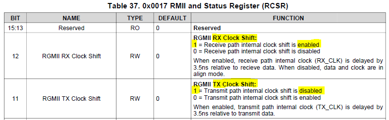

DP83822I: clock shifts
Part Number: DP83822I
See below copied from the datasheet. It clearly states that for the RX internal Clock shift, a “1” is enabled, but for the TX internal clock shift, a “1” is disabled.  That seems strange. Please verify this is correct. We want to enable both the TX and RX internal clock delays and I want to make sure we’re doing it right.
