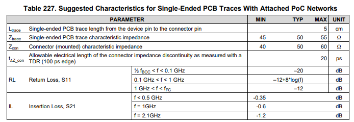

Based on TI recomendation regarding PCB Tracks impedance of FPDLink, we have this table:

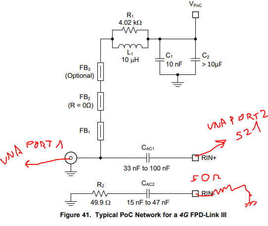

Since you have to measure the S parameters working in PoC mode, I mean single ended, could you confirm, which is the proper way to do this measurements?, with VNA. As far as I understand:

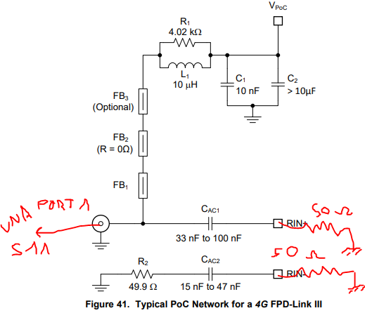

Measurement of S11 parameters, 954 IC has been removed from the PCB, and two termination resistor has been soldered
In this case, to measure S21 Paremeter.
