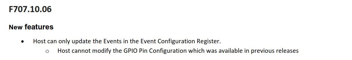

I'm trying to get a clarification on this statement in the new firmware. What exactly is no longer available to modify? Parts of 0x5C register? Are the GPxx tasks still available?

    I guess, I'm still not quite clear what exactly is the "feature" that this new firmware brings. It says that "Host can only modify events in Event Configuration Register" - "Host Cannot Modify GPIO Pin configuration which was available in previous releases".
    1) Event configuration register is the 0x5C, I don't see any other register in the spec that could fit the description?
    2) GPIO Pin configuration is also 0x5C, correct?
    3) The new feature blocks parts of the register for writes and unblocks others?
    Ilya

    There's certainly a misunderstanding. So back to original question which I still don't know the answer to.
    As quoted from firmware update document for FW F707.10.06 :
    "Host can only update the Events in Event Configuration Register" - What exact register address and bytes Host can update?
    "Host cannot modify the GPIO Pin configuration which was available in previous releases" - What exact register and bytes host can no longer modify?
    Ilya

  • Ilya,
    Let me clarify, and do let me know if you've additional queries on the topic:
    • By 'Event Configuration Register', we mean the 'GPIO Configuration' (0x5C) register as defined in Table 3-72 of http://www.ti.com/lit/ug/slvubh2b/slvubh2b.pdf.
    • 'Mapped Event' for GPIO0 - GPIO22 correspond to Byte33 - Byte55 of 'GPIO Configuration' (0x5C) register.
    • By "Host can only update the Events in Event Configuration Register", we mean that only 'Mapped Event' field of GPIO #X (where X is 0 - 21) configuration in 'GPIO Configuration' (0x5C) register is available for run-time configuration. Meaning (and for example), an event 'PlugEvent_Port1' assigned/mapped to GPIO0 can be changed to 'Cable_Orientation_Event_Port1' at run-time by updating Byte-33 of the 'GPIO Configuration' (0x5C) register. Note that the host shall explicitly reinitialize the GPIO status before mapping a new event to it.
    • By "Host cannot modify the GPIO Pin configuration which was available in previous releases", we mean that no other fields of the 'GPIO Configuration' (0x5C) register except for 'Mapped Event' are available for run-time configuration. Meaning (and for example), the 'GPIO Polarity' cannot be modified by editing the GPIO_EVENT_POL field of Bytes 61-64 of the 'GPIO Configuration' (0x5C) register at run time.
