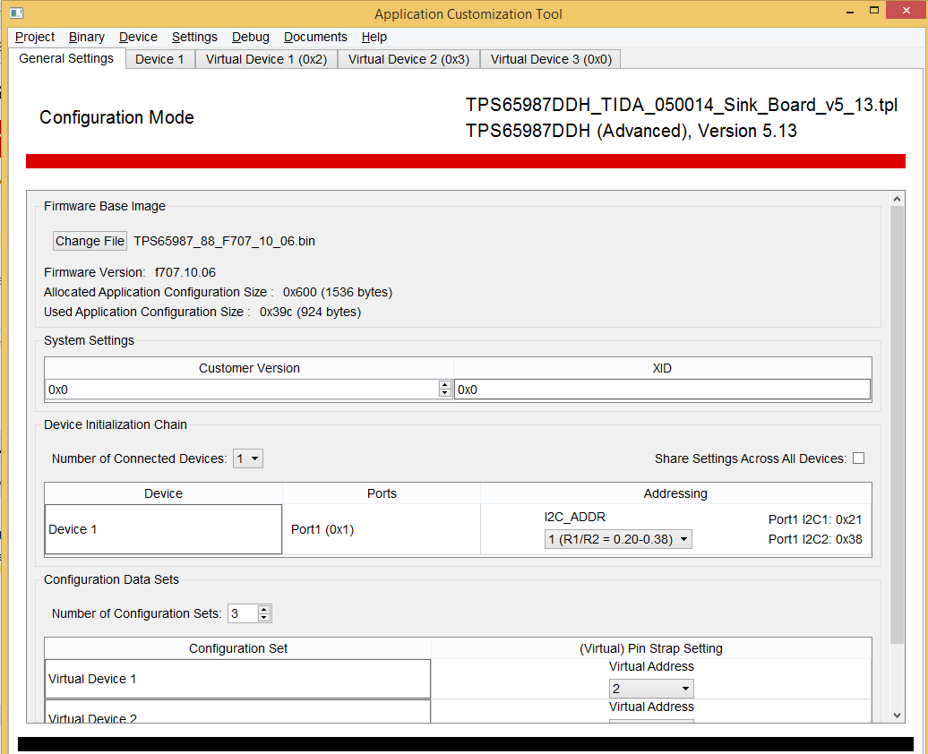

    I found one design from TI which has similar application as ours & that design is "TIDA-050014". In application customization tool, I selected Project---->New project---->TPS65987DDH---->TIDA-050014 Sink board.  It shows like below
    Now I gone to Binary---->Save binary....Saved low region file of this project.
    Then I connected my EVM "TPS65987-90 Evaluation Module" and flashed this saved binary to EVM. But when I connected type C adapter to EVM it is showing 5V voltage only.(Then I did 're-Flash EVM firmware' to get back to initial config). Can I get the binary or project file of TIDA-050014 which can give 20 V at VBUS in EVM so that I can test that in EVM as well as my board?

    Thank you for the further explanation. There are two issues with what you described. The first is when creating a bincary image you intend to load onto the external flash. Your sequence is correct, but instead of clicking to save the low region of the project, click to save the full flash image. The low region is typically used when using an external EC to push the patch bundle while the full flash image is used for an external flash.
    The second issue is that the TIDA-050014 project uses the buttons populated on the PCB to change the sink capabilities advertised to a source charger. The default state of the TIDA-050014 is only 5V. Here is an excerpt from the user's manual, explaining how the pushbuttons work.
    "TIDA-050014 is designed to request four different PDO's depending on what the customer is wanting to
    test. 9V_PB_SINK, 15V_PB_SINK, and 20V_PB_SINK are connected to three individual GPIO pins on the
    TPS65987D. 5V_PB_SINK will be connected to HRESET. When the push buttons are not pressed, each
    of the GPIO's will be pulled low. Upon initial startup, each GPIO will be pulled low and the TPS65987D will
    go in its default state of requesting 5 V. When a push button is pressed, its corresponding GPIO will be
    pulled high, and then that sink voltage will be requested by the TPS65987D.
    For example, a USB Type-C PD source controller, capable of supplying up to 20 V, is connected to the
    TIDA-050014. The TIDA-050014 will go into its default state, and request 5 V from the source controller. If
    the user wants the sink voltage to change to 20 V, they would then press the pushbutton labeled "20 V".
    This will pull 20V_PB_SINK and it's corresponding GPIO high. The TPS65987D would then request a 20
    V PDO from the source controller, and the voltage on VBUS would then rise to 20 V. If they wish to return
    back to 5 V, press the button labeled "5 V". This will pull 5V_PB_SINK and HRESET high, and the
    TPD65987D will reset. When the TPS65987D comes back on, it will then request it's default voltage of 5
    V."
    I would recommend using one of the default UFP templates to make sure that your setup is capable of sinking a high voltage contract, and then from there, you can begin to port over different features you valued from the TIDA-050014 template.
