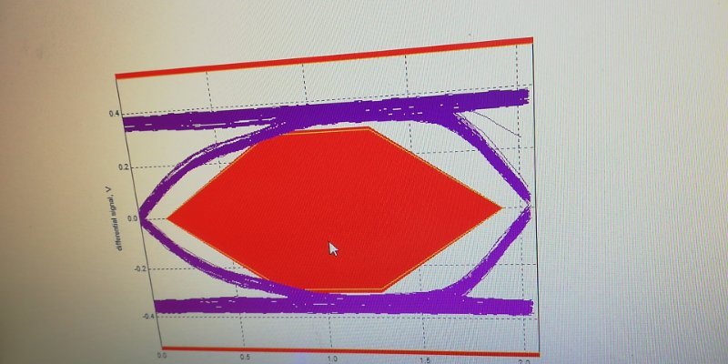

TUSB212: TUSB212 eye diagram pressed to the left template line
Part Number: TUSB212
Dear Team,

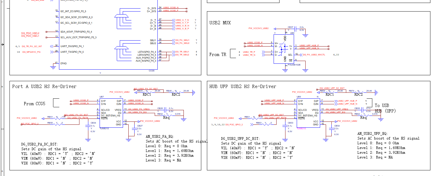

1.When using the TUSB212 redriver to test the eye diagram, the EQ is adjusted to 0R resistance to ground. JK 7mv.The left side of the eye is pressed to the warning line, and the right side is passed. Adjust DC_BST from 22 to 47K, but nothing changes.How to adjust if the slope can be adjusted.
2.My schematic
3.My eye diagram
thanks very much!
