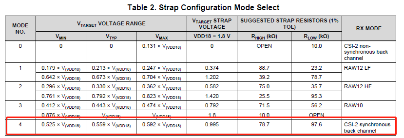

  • 1. It cannot be LOCK in synchronous mode, 936 MODE PIN is configured as follows:

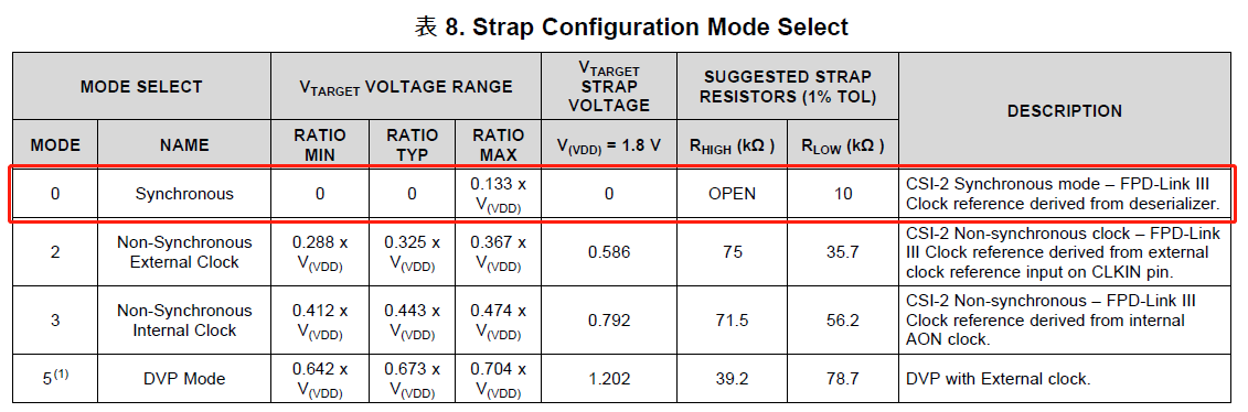

    The 935 MODE PIN is configured as follows:
    2. In the case that the above synchronization mode cannot be locked, customer changes the 0X58 register of 936 to 0X5A (936 works in non-synchronous mode). At this time 935 does not change, 935 and 936 can be LOCK, and LOCK is stable.
    3. Base on above 1 and 2, by modifying the 0X30 register of 935, and changing to 0X4A (935 also works in non-synchronous mode), at this time 935 and 936 can also be LOCK. And LOCK is very stable. The read/write front end SENSOR is also normal, and the video transmission is normal.
    Summary: Both ends can be LOCK normally in non-synchronous mode, and the video is transmitted normally. In synchronous mode, it cannot be LOCK. Would you share me your suggestion?

  • Hi Annie,
    Please do not change register 0x30 and 0x4A.
    In Synchronous mode they need to write the following sequence on the 936:
    1) chose the correct Rx Port in reg 0x4C. If Port 0 is used then write 0x01.
    2) Register 0x58 should be set to the value 0x5E.
    3) 0x6D should have the value 0x7C
