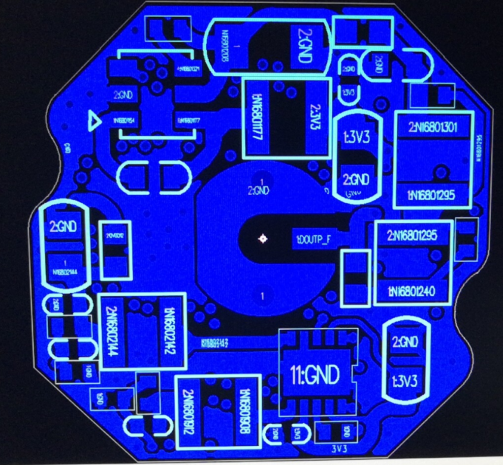

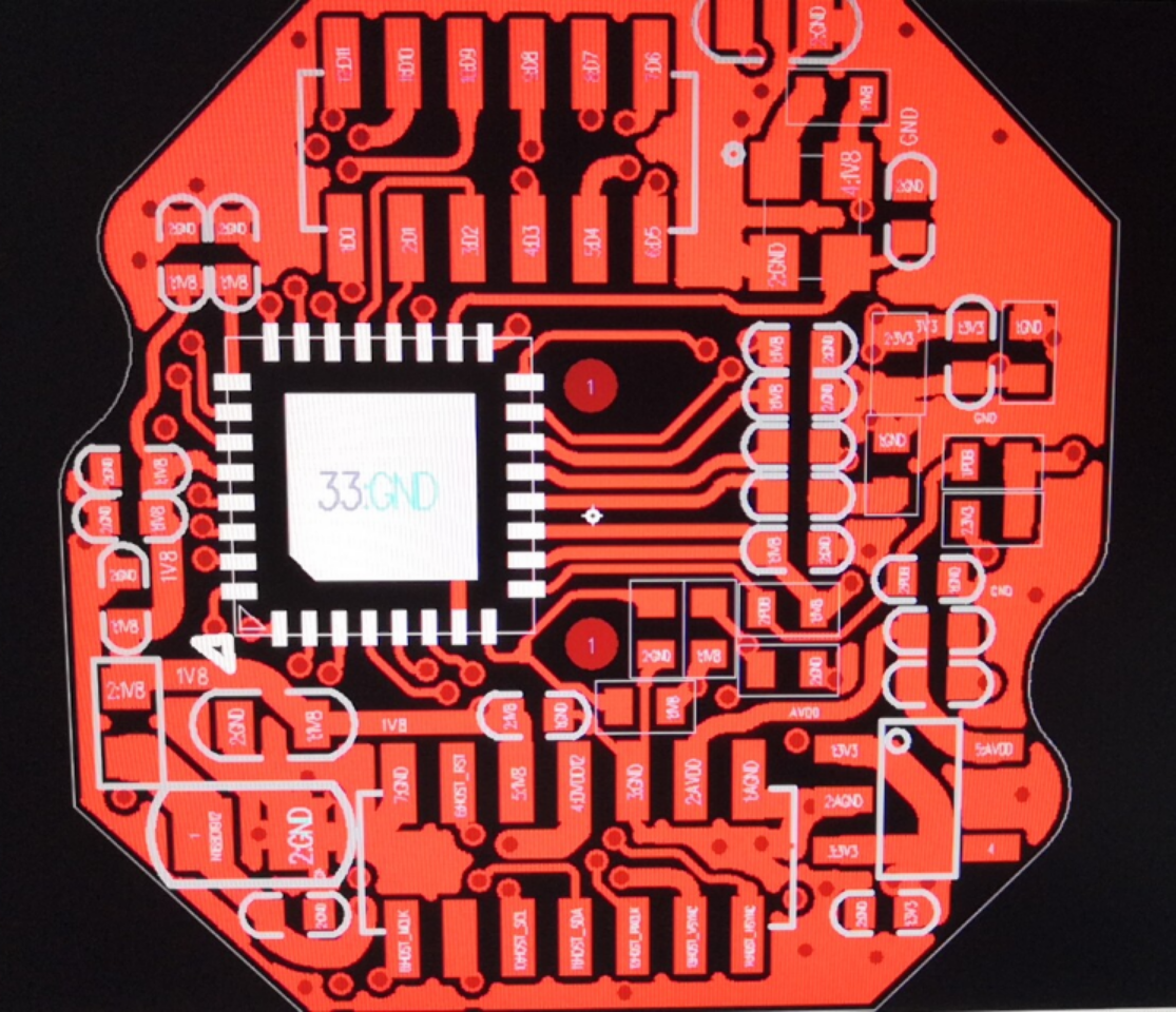

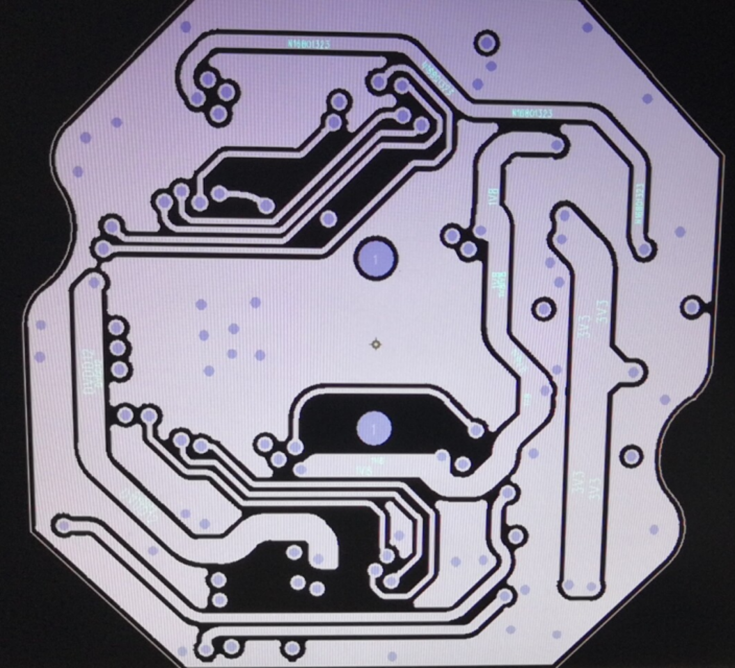

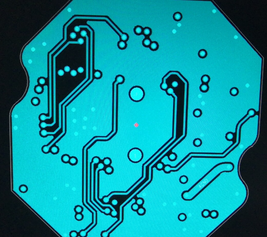

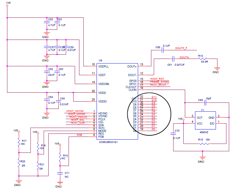

Hi
   A new camera module using DS90UB933+ISX019. 914 is verifyed ok as 914 can connect another 913 or 933 board. When the new camera module connect 914, the Lock pin of 914 is low and 914 and 933 can't commucate by I2C. That say the system of 914 board can't find the I2C adress of 933. Can you help to check ?
 Another, PCLK of old module( they are ok) is from imager,  but this new module is from external OSC.
If LOCK pin of 914 is low, Could the I2C communication be normal ?
