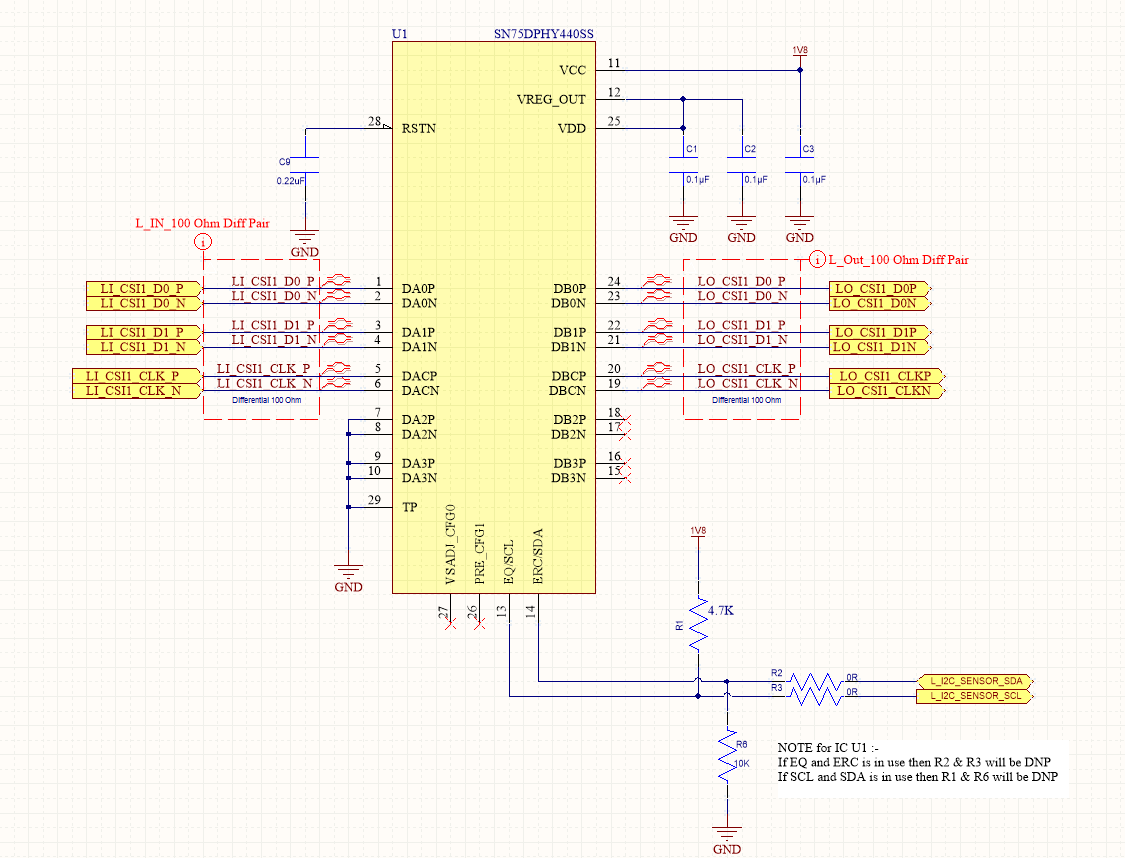

Part Number: SN75DPHY440SS
We are using 1080p60 sensor 2 data lane and 1 clock lane of MIPI CSI-2.
what could be the power consumption of 1.8v rail?
