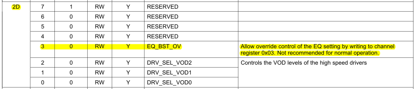

I found one register which may be needed to be set when manually setting the CTLE gain. REG 0x2D [3] seems to be required to be set.

  • Hi Kawai-san,
    The 2D register definition is shown here
    This register is used to override the CTLE input equalization setting.  The equalization setting is written into register 0x03.
    Lee

    Going back to my first question, if REG 0x2D [3] is required to be set, all the customers who uses in the fixed EQ gain (CLTE) mode are using the wrong register setting, since the datasheet procedure does not describe to set REG 0x02D[3] = "1" in datasheet page 23.
    I want to make sure what is the specific difference of the setting between REG 0x2D[3] = "0" and REG0x2D[3]= "1" in the procedure shown in the datasheet (SNLS397D) page 23.

    Sharing information.
    To manually fix the CTLE boost gain,
    - REG 0x2D [3] = 1 is not required when used in Adaptation Mode = 0.
    - REG 0x2D [3] = 1 is REQUIRED when used in Adaptation Mode = 1,2, or 3.
