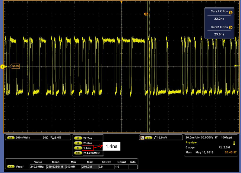

I set DS90UB914A-CXEVM to "12-bit LF mode" and DS90UB913A-CXEVM to "PCLK mode".
The clock for PCLK is 48 MHz.
12-bit LF mode: 1 UI = 1 / (PCLK_Freq. x 28) = 0.74ns(1.35Gbps)
However, the actual waveform is 1.4 ns (714Mbps)
How can I get it to work at 1.35 Gbps?
