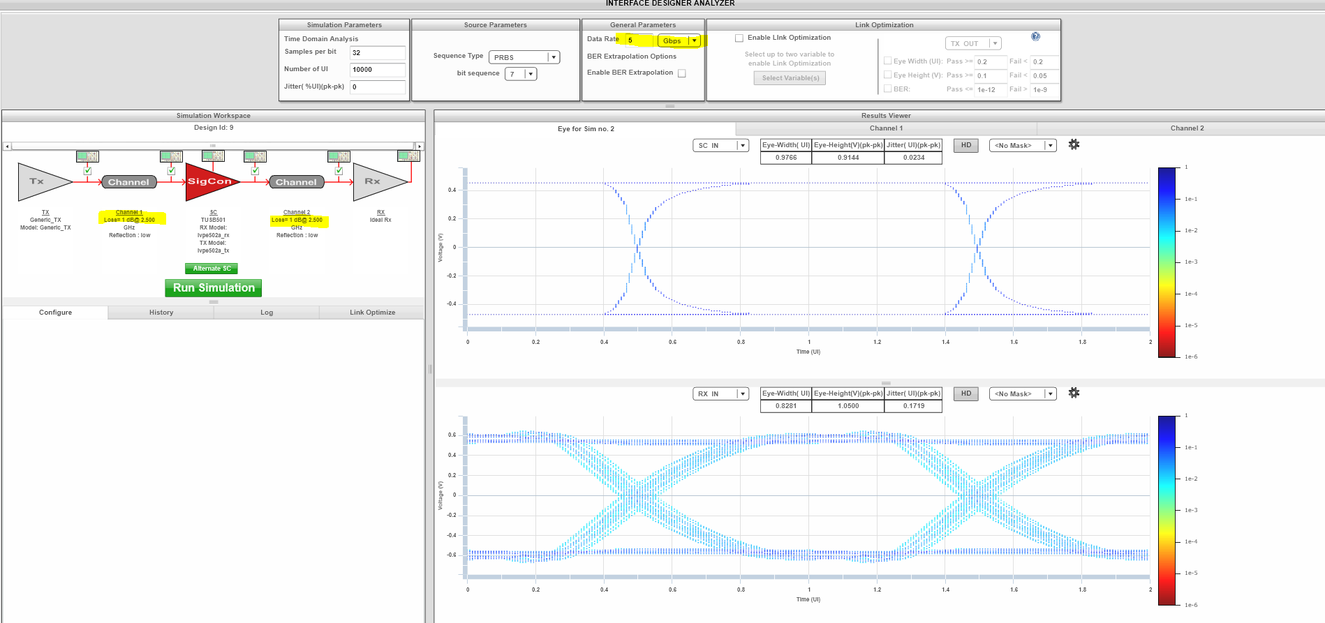

    Could you describe the simulation setup that was run? Please see image below for setup and result from Webench I was able to generate. Pay attention tot he highlights in the image below and your test setup. Is TUSB551 not available in webench? There is a publicly available Hspice model for use if necessary.

  • Hi Domenico,
    Could you describe what your application is? What is the s4p file supposed to represent? The S4P file you provide shows a large insertion loss at 2.5 GHz. Does your USB Host TX have some pre-emphasis that should be included? There are also many ripples in your s4p file which usually indicates there are impedance mismatch in your system.

  • Hi Domencio,
    I recommend taking the s4p file with the SSD in the path, generally only transmission media is included in the s4p file. A large amount of loss should be expected form this setup. If the amount of loss is greater than the equalization at the re-driver receiver  then the eye will not be able to be opened. You may consider changing the placement of TUSB501. Right now the TUSB501 is place at the end of transmission media in the simulation (after last flex cable) and nothing on the post channel.  I was able to obtain an eye opening with around 10.76 dB loss at 2.5 GHz on the pre-channel and 5 dB loss at 2.5 GHz on the post-channel with high reflections.

  • Hi Domenico,
    With your current model the answer is no however the model does have some issues that can cause the simulation to look worse than it could actually.
