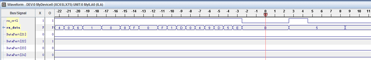

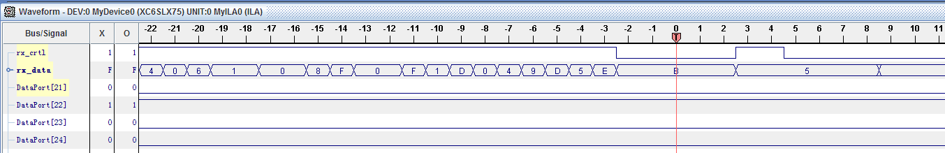

DP83867E: What does the short rx_crtl after a long pachet indicate?
Part Number: DP83867E
Hi , when I set the phy as digital loopback, there will be a 2 clock short rx_crtl after a long rx_crtl encountering CRC error,as showed in the below picture . My question is what does the short rx_crtl indicate? Does it mean an error encountered or the start of a new frame that is ended shortly?
