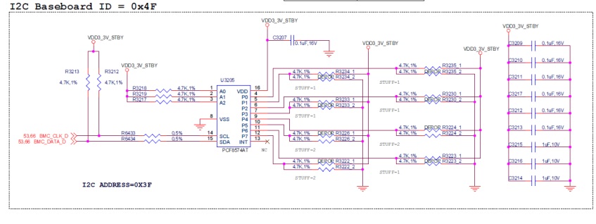

Hi There:
I'd like to check an application schemtic as following, if using PCA9534 to replace PCF8574 (NXP's P/N).
What items need to be take care or which issue would be happend if directly swap those two?
  • Hey Kay,
    May I ask why you are making a switch from the PCF series?
    "What items need to be take care or which issue would be happend if directly swap those two? "
    The major difference is that PCF device does not have internal registers to set while the 9534 has 4 registers. The software would need to be changed to be able to address this difference.
    -Bobby

  • Hey Kay,
    I would recommend our TCA family. It is more cost competitive than our PCA line up and fixes some bugs from the older PCA design. They also support wider Vcc ranges.
    I have example C code from an Arduino MCU I made for fun on my off time (See Below). We typically do not off software support/drivers for our I2C devices. Also please do not treat the code below as something that represents/owned by TI as Arduino is open source and the code was developed outside of TI.
    Code was written for TCA6416A but it should be similar to PCA9534/TCA9534 in the sense of accessing registers through I2C.
