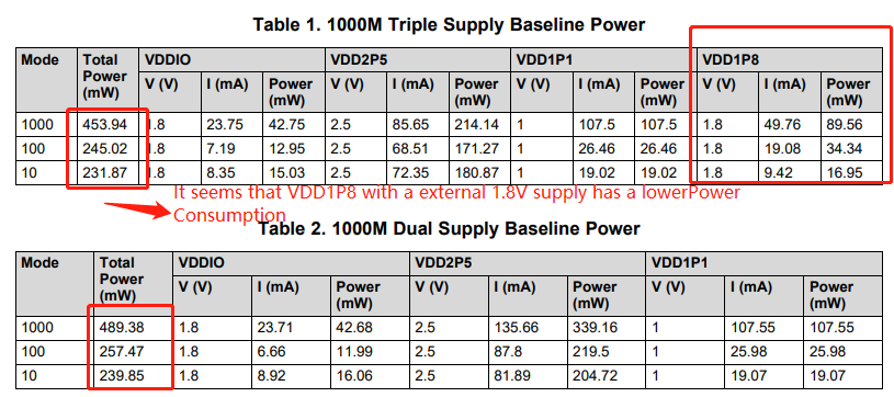

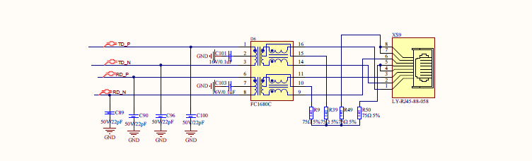

         The following picture is the sch and power consumption test . I have some questions:
         1. When use SGMII , is the sch correct?
         2. can the linux driver from TI official (https://git.kernel.org/pub/scm/linux/kernel/git/torvalds/linux.git/about/) be uesd SGMII?
It seems that the driver is specific to RGMII. If the driver is not suitable for SGMII, are there any new drivers available?
         3. Whether SGMII or RGMII is used, must VDDA2P5 and VDD1P0 exist simultaneously but VDDA3 is optional?
Does VDDA3 have an external 1.8v supply that only affects the Power consumption?

    I see that only two channels are used, is this going to be only 10/100Mbps design? Also Channel C and D are used for DP83867, are you using mirror mode?
    Are the SGMII MAC traces differential? SGMII_SIP/SIN are inputs to the PHY and SGMII_SOP/SON are outputs from the PHY. Make sure that they are connected to correct positions on the MAC.
    The online driver does not enable SGMII by default. SGMII will have to be enabled via strap resistors or register write.
    I do not see VDDA3 on the schematic, do you mean to ask about VDDIO? If you are asking about VDDIO, then it is not optional. VDDA2P5, VDDIO, VDDA1P0 are all required. VDDA1P8 is optional.

  • Hi Aniruddha,
    Yes, the sch. is designed for 10/100Mbps mode.
    Yes, it is mirror mode, since pin 1 2 4 5 are opening, I think hardware designer want phy working at mirror mode, we can write register(reg 0x31 bit0) to enable mirror mode, am I right ?
    Pin LED_0 is just connected to VCC, is this correct ?
    it should be connected to the correct positions on the MAC side, we had used another phy chip(AR8033), it is connected to the same pins on the MAC side.
    we can write register in the driver(reg 0x10, bit11) to enable SGMII mode, right ?
    No, it is VDDA1P8, I guess VDDA3 is typo.

  • Hi Jophse,
    You can see that for all higher address registers, the register value is 0xFFFF. This is because address higher than 0x1F need 'Extended Register Space Access'. This is mentioned in the datasheet in section 8.4.2.1 Extended Address Space Access
    You can definitely enable/disable mirror mode via register 0x31 but first you will need to implement Extended Address Space Access.
    Can you also try writing '00' to register 0x31[6:5]? This will increase SGMII auto negotiation timer to 16ms.
    Lastly, for far end and near end loopback, you can use register 0x16[5:2]. Enable reverse loopback for looping back data on the cable side. Enable Analog loopback to reverse data on the MAC side.
