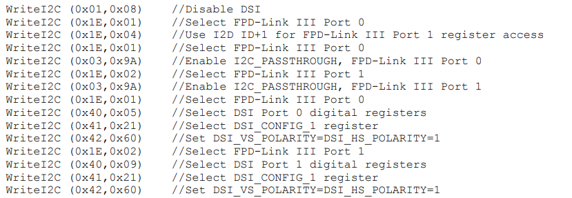

Would it be possible to provide a sample configuration code to get a checkerboard (or any sample pattern) working on the 941AS? Output is dual FPD-Link to a 948 deserializer. Ideally the sample code will be similar to what is provided in section 8.4.5.2 of the datasheet, but for pattern generation.
