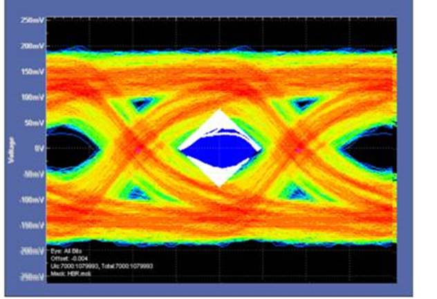

Hi Team
            I have use DP130 and Eye test fail. The Output Swing to low.
I have use I2C setting.
05H =  FF ( I2C Enable , -9db(HBR) , 18db(HBR2) )
06H =  FF ( -9db(HBR) , 18db(HBR2) )
07H =  FF ( -9db(HBR) , 18db(HBR2) )
08H =  FF ( -9db(HBR) , 18db(HBR2) )
and
0x04 bit 2 = 0
0x15 bit 4:3 = 00 or 11
         bit 2 = 1
         bit 1:0 = 10
but test still fail.
Have any solution for this fail item?
