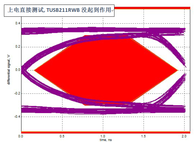

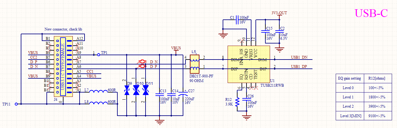

We find TS3USB221 have some jitter when eye diagram testing, see below test scope and schematic, could you help to share any possible reason for it? thanks.

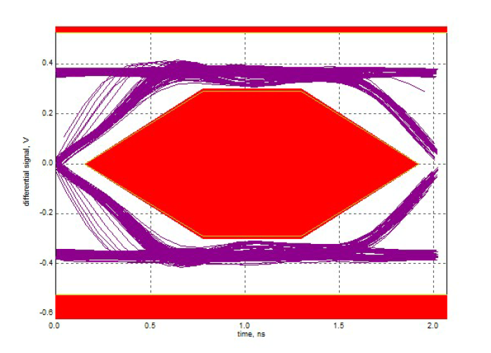

Hi Brian and Malik,
Sorry for my typo error, it should be TUSB211.
when TUSB211 doesn't work, there is no jitter, see below scope. The jitter will exist when TUSB211 working. is it normal?

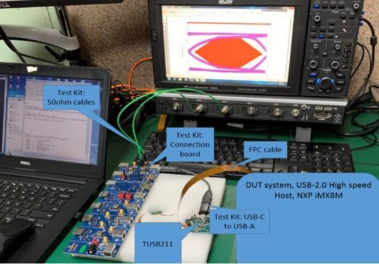

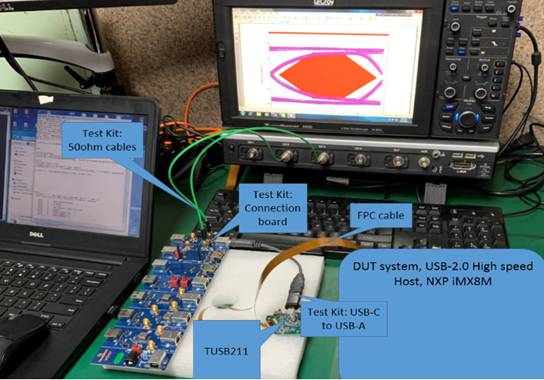

Test flow:
1.connect all the cable
2.Power on the DUT
3.start to test
4.sometimes the OSC couldn’t catch the signal, power off the DUT,and then reconnect the cable between the OSC & test jig, and restart
