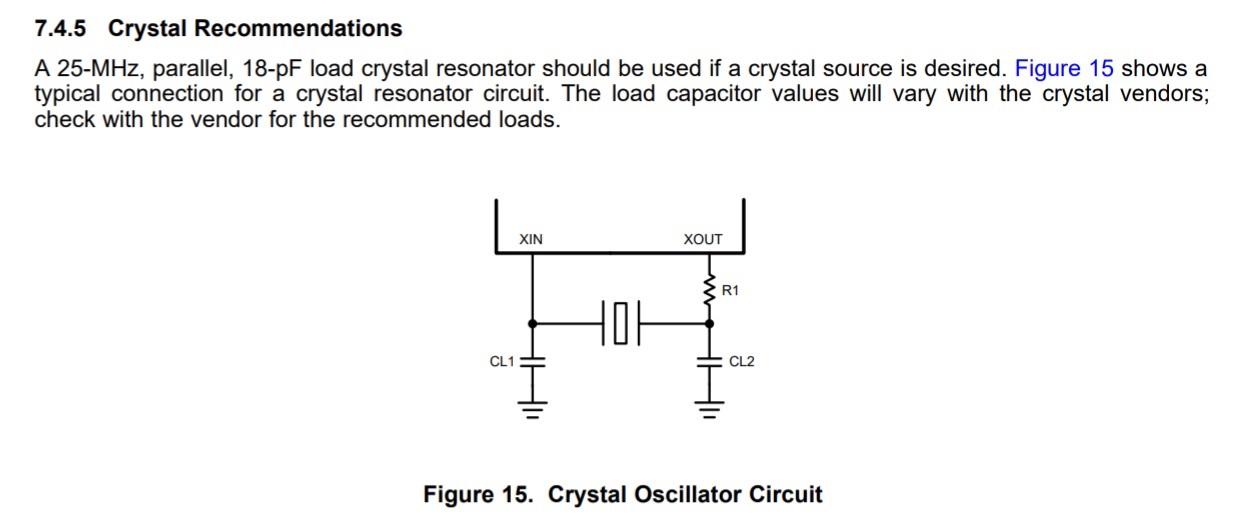

I want to use an external clock for the DS90UB936-Q1.
The data sheet states that NC should be processed for Xout.
However, Xin / Xout is connected to other pages as shown below.
There is no problem with Oscillator.
However, if you are using Crystal, you must connect both IN and OUT.
We are going to use Crystald.
Can you tell me how to connect the circuit?
