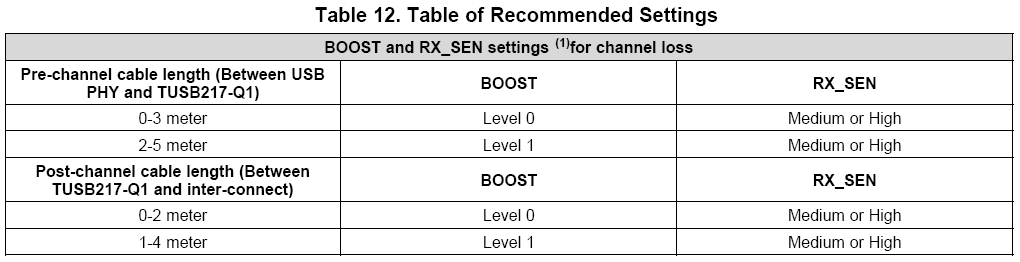

The following is the description of cable length and boost level in the TUSB217-Q1 datasheet:
In our application, there are two kinds of Pre-channel cable length:pre=0.9 meters and pre=4 meters, post=0~2 meters.
But we can not do two different hardware to meet customer's requirements,So can we set BOOST=level 2 and RX_SEN=high to meet the
application of Pre=0.9~4 meters? Does TUSB217-Q1 work steadily for a long time after this solution?
