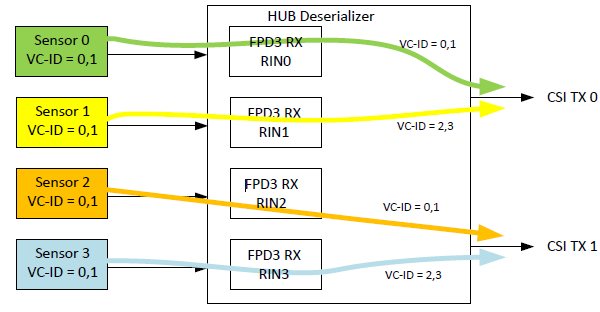

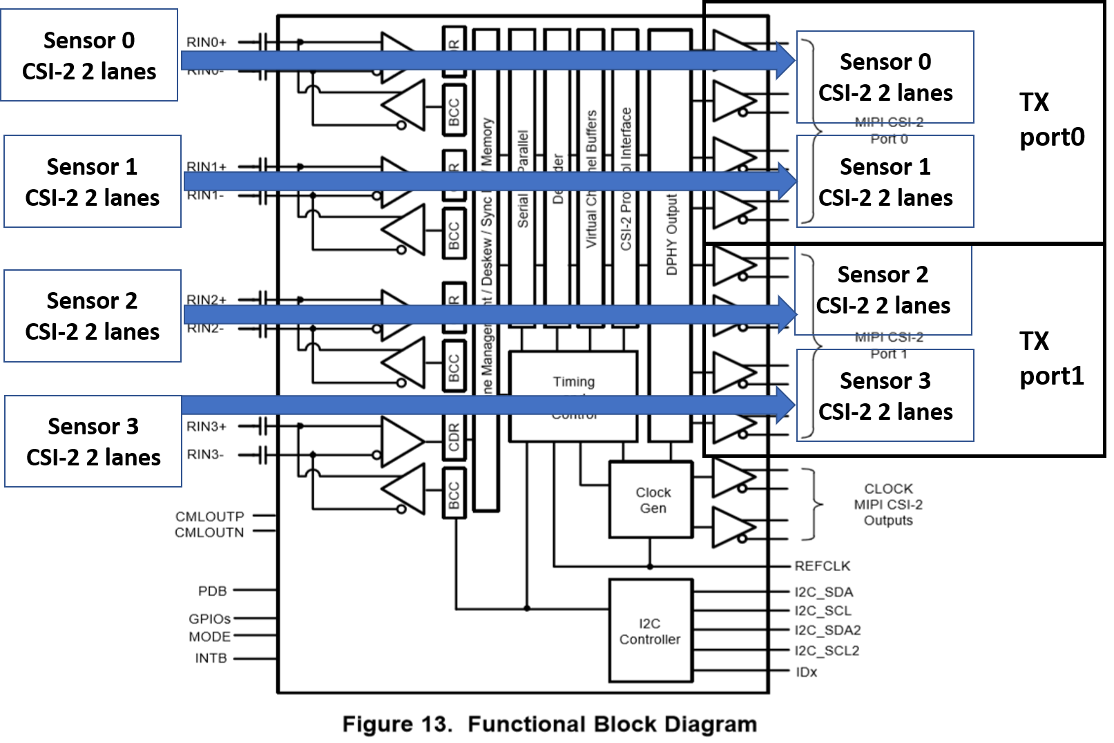

we designed DS90UB960 and DS90UB953.
We need to mux CSI-2 data of Sensor0, Sensor1. and mux CSI-2 data Sensor 2 and sensor3.
we are using CSI-2 2 lanes data of each sensor.
DS90UB960 support mux CSI-2 data input and CSI TX can support as below structure?
If possible. how to set the register of DS90UB960. please let me know the guide.
