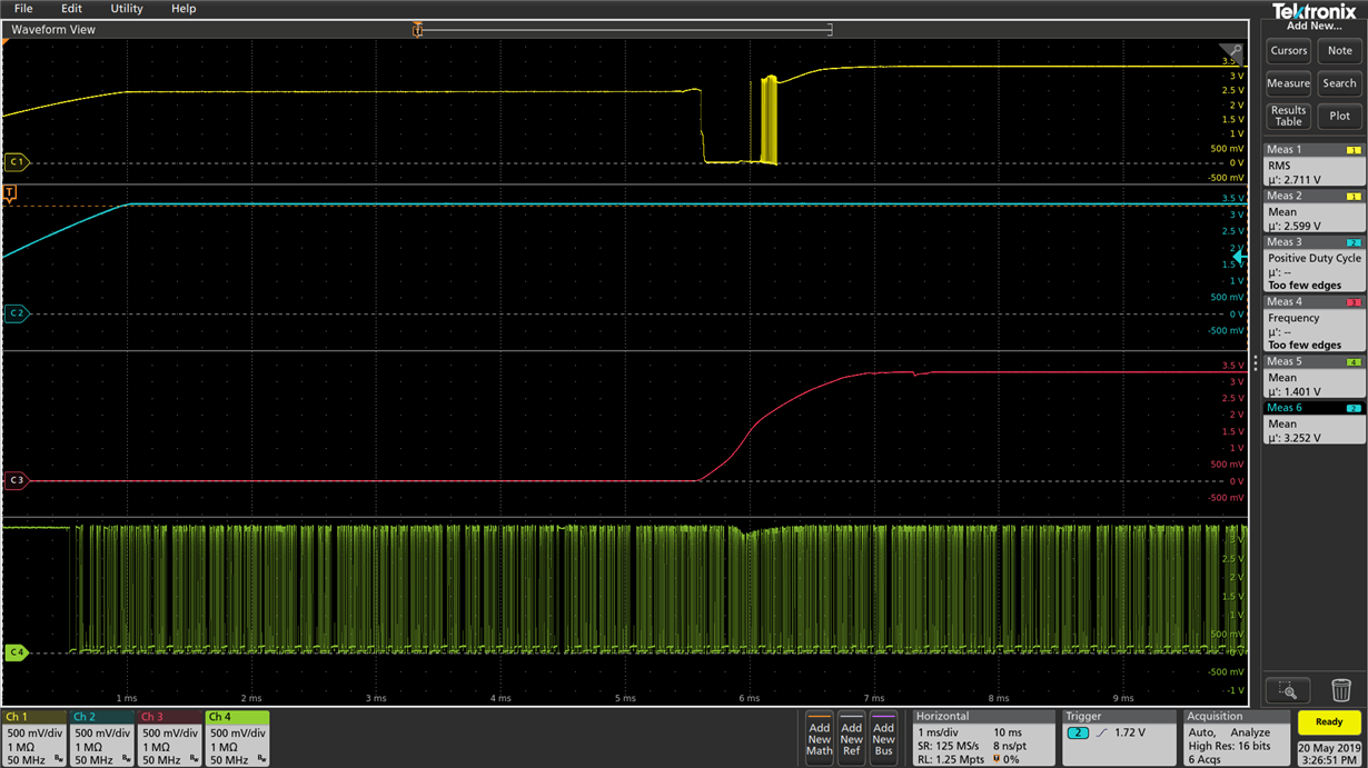

TPS65988: I2C lines during power-on
Part Number: TPS65988
Hi Team,
My customer is seeing a droop on their I2C line connected to the TPS65988 while powering on the device (see image below, green is the I2C communication, red is the 3.3V PD controller supply, ignore other two lines). It looks like the PD I2C bus is getting released before it has reached 3.3V, and they are concerned that this drop could cause an undesired low bit.
Do we have any recommendations to help prevent this from happening?
