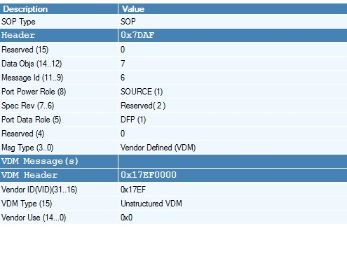

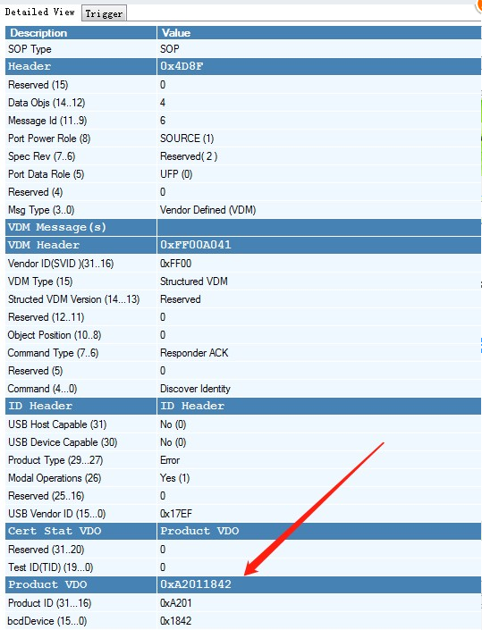

Hi Team,
My customer used 2 different firmwares (TPS65987D_rom1p2p1_DRP_Advanced_3p10_Bitland_Support_VDM_0925 and TPS65987D_rom1p2p1_DRP_Advanced_3p10_Bitland_Support_VDM_UFP) for TPS65987D. With the 0925 firmware, the device can get the VDM information, while with UFP version it cannot (see below captures). Could you please help to check the difference between the 2 firmwares? (Firmwares are in the attachments)
Firmware.zip
