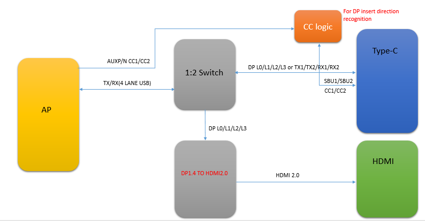

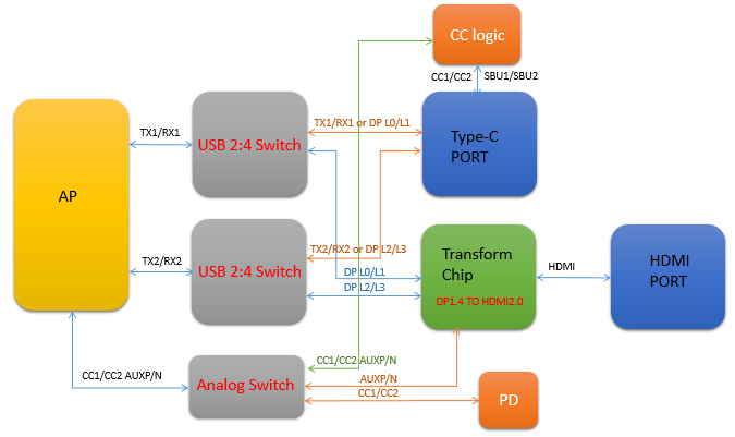

Hello
Because Type C need to support USB3.0 and DP ,meanwhile,it also need supoort DP tranfer to HDMI, 1:2 switch maybe is the easiest, Please help to check if HD3SS6126 could meet this demands ?
or recommend it if it has better device choice, or this sullotion need to match with more another device
