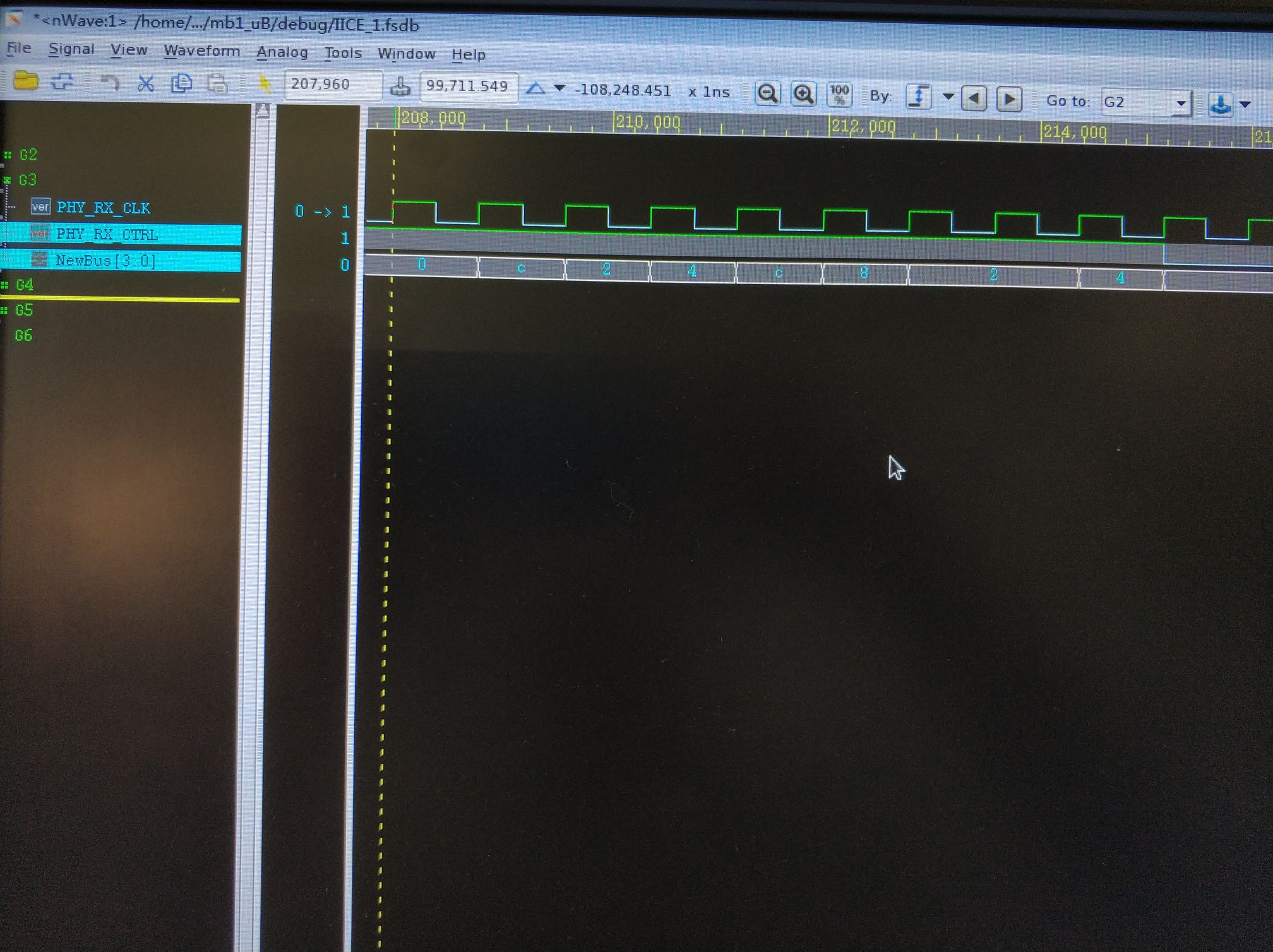

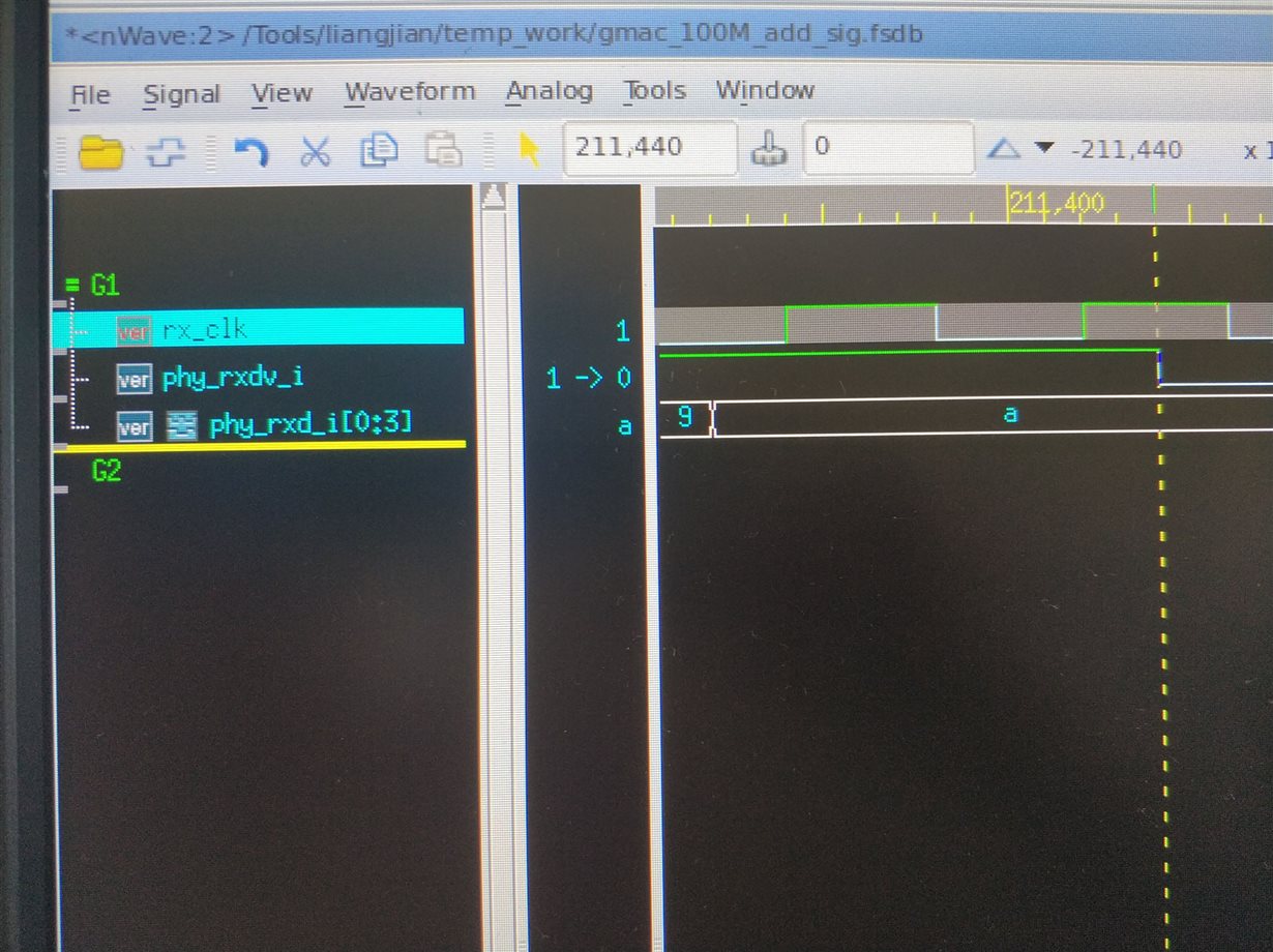

    The current scene is two mutual exchanges, the sampling clock is 100M;
    10M Ethernet is ok, when rx / tx clk is 2.5M
    100M Ethernet does not work when rx / tx clk is 25M. At this time, rx error will be reported. It is found that rx ctrl is high at the last beat and the falling edge becomes low.
    Is this what is the reason
    Figure 1 is the waveform of the oscilloscope, Figure 2 is the waveform captured inside the FPGA, RX_CTRL duration, about 5738ns (71.5 RX_CLK)

  • Hi Ross
       We have spent a lot of time on debugging DP83867IR, and this PHY still fails receiving data in 100M ethernet mode.
       By capture waveform on FPGA,we find that phy RX_CTRL signal drop too early, and the high 4bit of the last byte in test packet is missing which will lead to CRC check err in MAC.
       I have take picture of 10M ethernet and 100M ethernet waveform attached in this mailand the capture clk in FPGA is 100Mplease check it and thanks a lot.
    Below is 100M_ethernet_mode_with_wrong_rx_ctrl:
    Below is 10M_ethernet _mode_with_right_rx_ctrl:
    Thanks a lot.
    BRs
    Elsa Duan

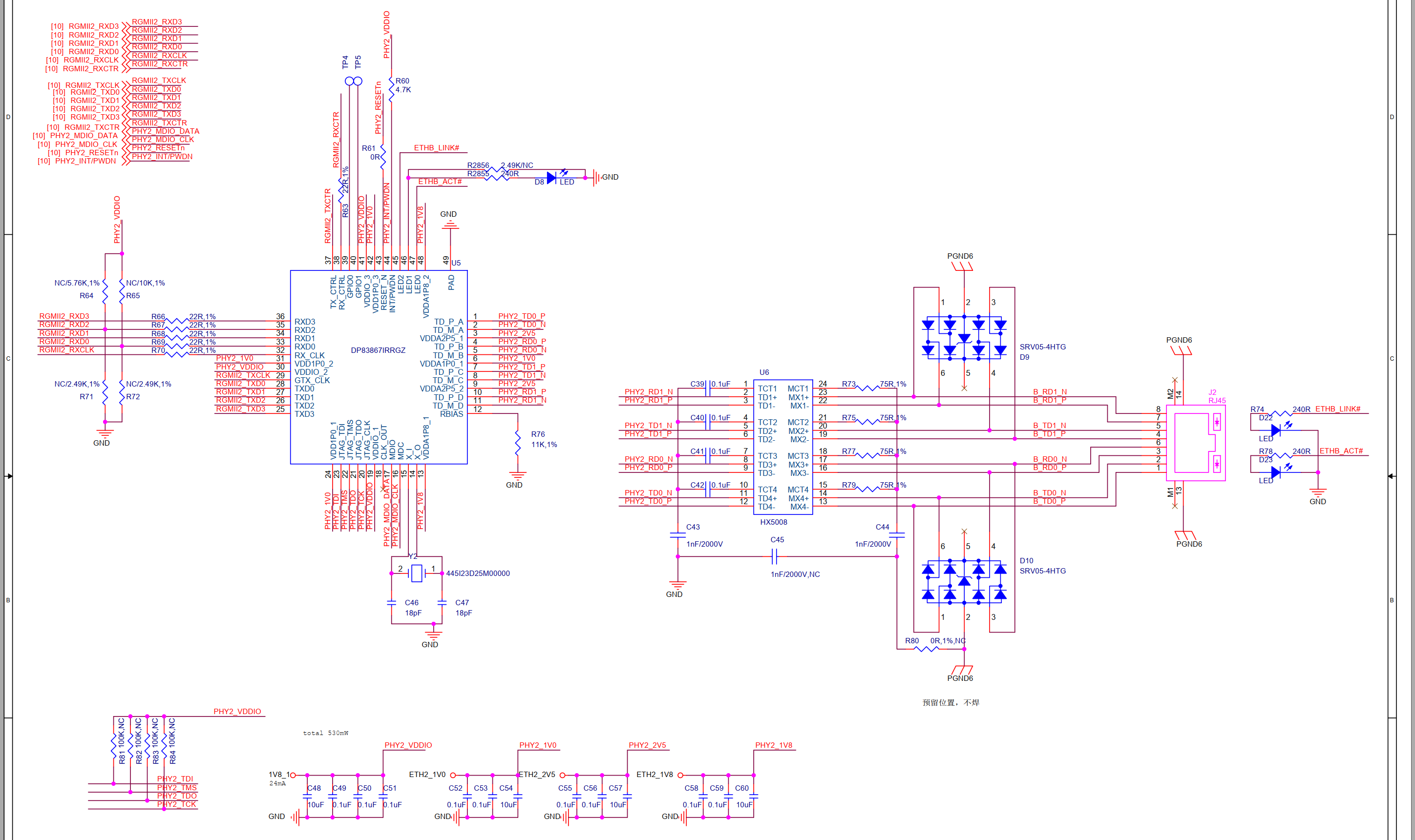

  • Hi Elsa,
    I think I see what the issue might be here.
    Are you implementing any trace delay between data and clock through the track routing?
    Are you implementing any delay in the PHY before the PHY transmits the RX data out?
    Are you implementing any delay in the FPGA once the RX data is received?
    Based on your schematic, you are operating in align mode where clock and data edges are aligned.
    You need to enable some sort of delay through either the track, PHY or MAC.

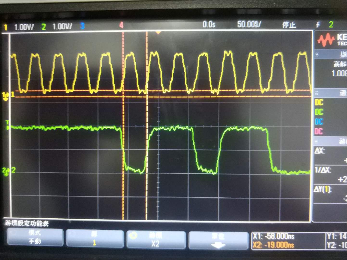

  • Can you send me a capture of the actual RX_CLK to Data and not the FPGA clock please?

  • Hi Ross,
    I have take a picture of oscilloscope, the yellow channel is RX CLK, and the green channel is RX DATA0.
    It's an urgent case for me, Looking forward to your reply.
    Thanks a lot.

  •  It's urgent case. I have take a picture of oscilloscope, the yellow channel is RX CLK, and the green channel is RX DATA0.

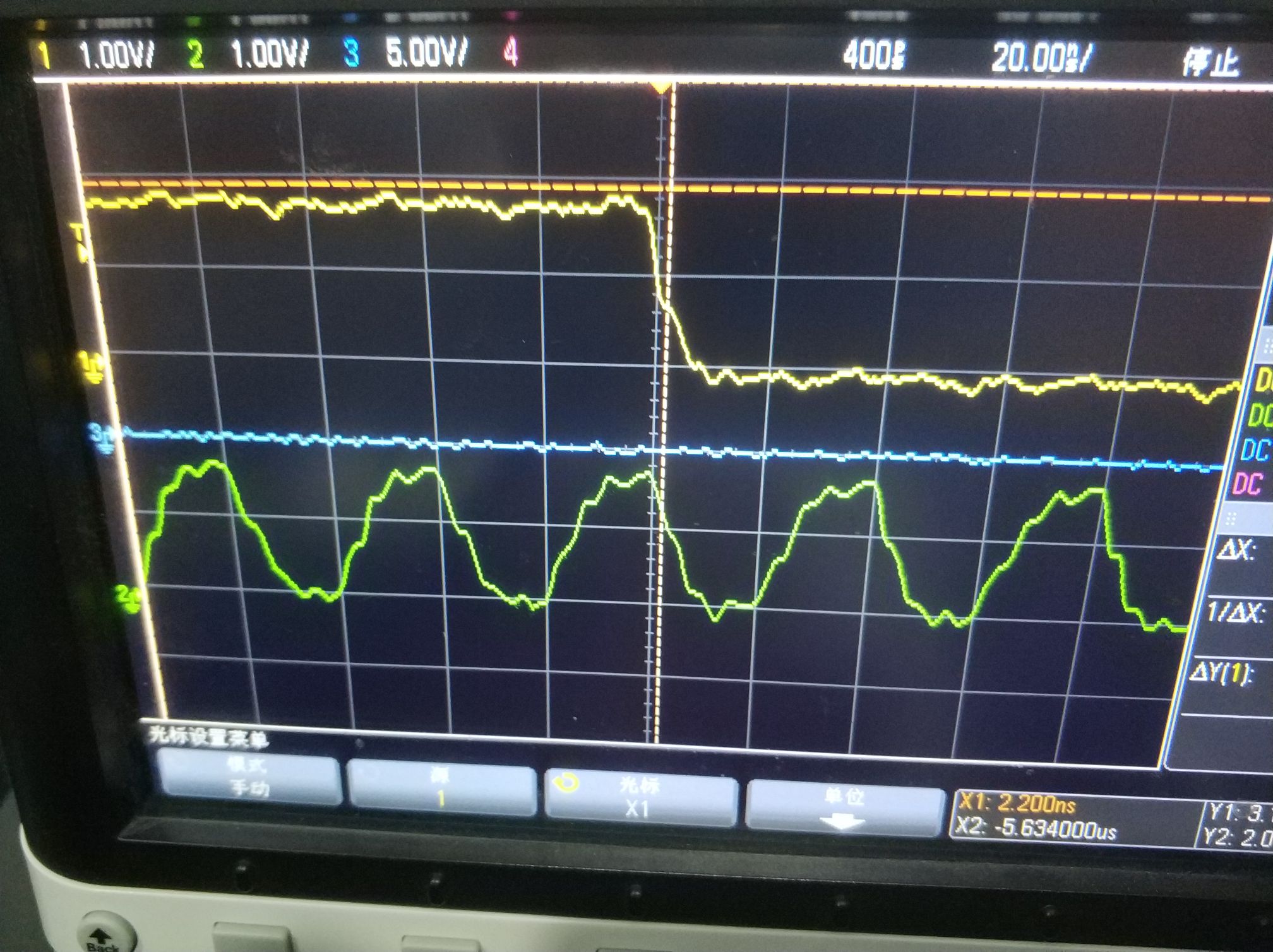

     1. Can you please tell me how the loopback tests ended up?
        The PHY loopback still fail in 10M mode and 100M mode.
        While in 10M mode, the PHY can send right data received from another PHY, I have attach two picture of the RX_data, RX_ctrl refer to RX_clk. Please note that the Rx_ctrl will drop low early in 10M loopback mode, while it is ok in normal 10M mode.
     This is 10M Loopback mode:
    This is 10M normal mode:

  • Hi Aniruddha,
    Thanks for your powerful support.
    By comparing the difference between the same waveforms of the data, it is found that the clock is not accurate enough, so the clock frequency is increased, and then the verification is found to be correct.
    So the problem has been solved.
    Thanks again.
