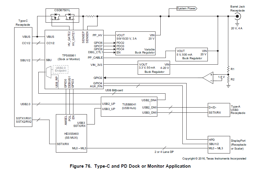

TPS65987D: Can the TPS65987 be used with the HD3SS460?
Part Number: TPS65987D
Other Parts Discussed in Thread: HD3SS460, TUSB1064, TPS65981, , DP-EXPANSION-EVM
I saw that the TPS65987-90EVM is used with the TUSB1064, can it be used with the HD3SS460? How to configure it?
I have TPS65987-90EVM and DP_EXPANSION EVM, can I use it together?
