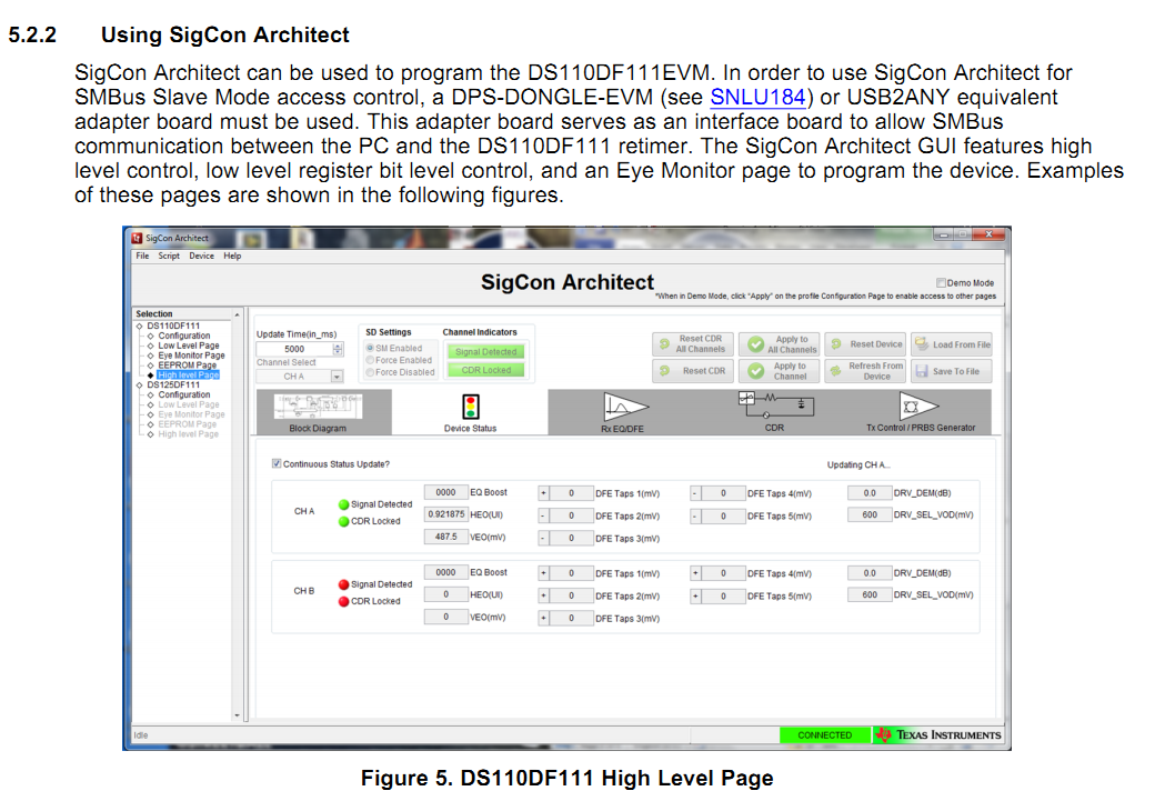

We use SigCon Architect  to program the DS110DF111EVM. In the User's Guide, we can see the page
But we got the page like this, please help check, thanks!

  • Hi Sherry,
    It looks like there is a signal present at both retimer inputs, but the CDR did not lock.
    Here is some additional information to help debug the issue.
    1. Schematic
    2. Input Datarate
    3. Any non-default register programming implemented in the application.
    Lee

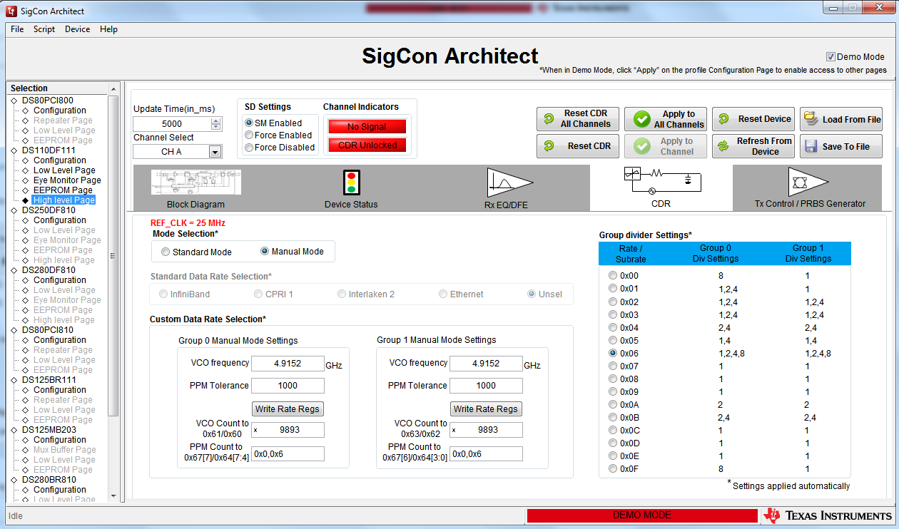

    In the course of using, the circuit is the same as the one shown below.
    Data rate is 5G,Four tablets were used in our practical application.
    I want to know,
    1、can these four pieces be synchronized?
    2、What should I pay attention to in the process of register configuration?
    3、Does the chip need to be placed on both sending and receiving sides when it is used?
    1. Multiple retimers can be used in the same application.
    2. Register configuration is important, especially since you are not using the default datarate some programming will be required.
    3. The channels are independent.  They do not need to run together.
    I would recommend using the following page to setup the retimer.  You will need to input the exact datarate into the VCO frequency box for your application.
    Here are the registers in the 0x60-0x64 range which get updated.  Also note I changed the Rate/Subrate setting in the picture above.
    Lee
