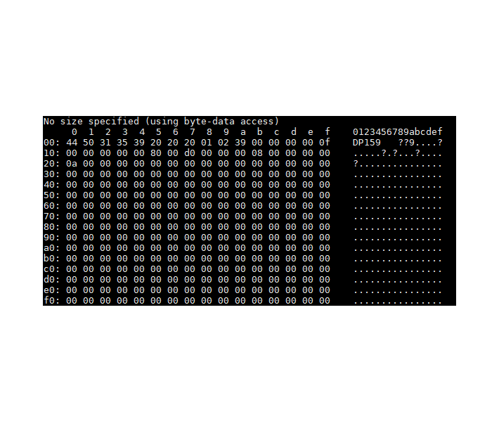

  • 1050.DP159.pdfhi David,
    the sch and dump register is as attached.
    the signal from FPGA is 1080p60, HDMI1.4.
    pls help double check whether there is anything unproper. I am asking them double check the ref clk as well. tks a lot!
  • hi David,
    the  dump register is as attached. I will send you the sch by email.

    Does FPGA support clock stretching on the DDC bus?
    The register dump shows input clock is locked, but please still check the clock signal as I would like to know when the clock became valid.
    Can you also see if you set Page 0 Register 0x0Ch to the value of 0x6C, does it help?

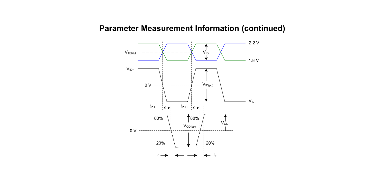

    customer has two issues:
    1. in d/s, it mentioned Input termination voltage is 0.7V, but from one of the d/s plot, it is 2V, Which one is true?
    2. if CLK in VID(PP) exceed 1200mV, will it cause the issue?
  • Vera
    1. Figure 5 is an example of input and output timing measurement, it is not an example to measure the Vterm.

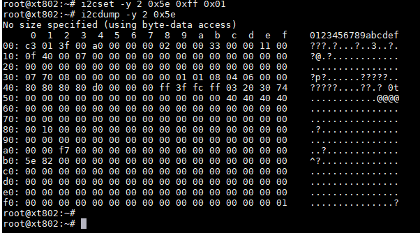

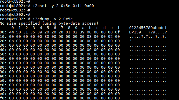

    2. Max VID is 1.2V, so it will not be an issue with the DP159.
    During the 2 to 3s before the video is stabilized, please keep looping the I2C read, the register we need to look for is Page 1 register 0x00h for PLL lock and Page 1 register 0xB1h for clock detect.

    For the 0x00 register, it sometimes changes from 0x02 to 0x03, and finally to 0xc3; sometimes it changes directly from 0x02 to 0xc3. I feel that this difference may be caused by  I2C access frequency limit. For the 0xb1 register, it goes directly from 0x02 to 0x82. And the values of these two registers will not change when the issue occurs.

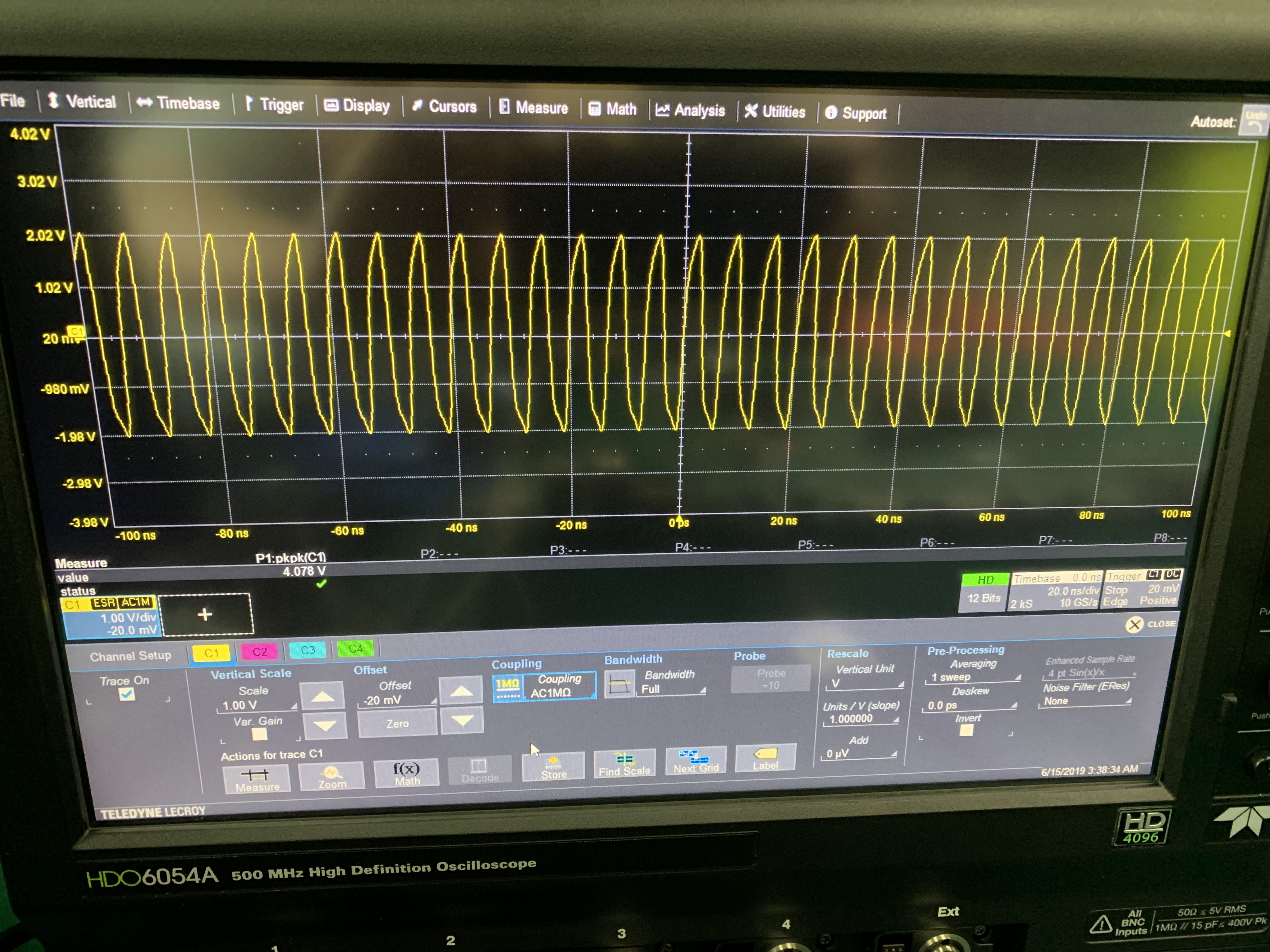

    Does the Max VID refer to the peak-to-peak value? I have measured a negative single-ended voltage between the coupling capacitor and DP159. Is this acceptable for  DP159?
  • Value 0xC3 is expected value for register 0x00h and value 0x82 is expected value for register 0xB1h register.
    0xC3 indicates DP159 is in re-timer mode, and PLL has locked onto the clock. 0x82 indicates DP159 has detected the clock. If you are seeing these bits toggle during the 2 to 3s when there is no display, this could indicate the input clock to DP159 is not stable and became stable after 2 to 3s. Can you please probe the input clock during the 2 to 3s when there is no display?

  • Hi David,
    These two registers stays the same when there is no display.

  • Zexiang:
        1.2v VID is single ended or differential? if single ended, it's too high.
  • Brian,
    The picture below is the voltage measured between the two AC-coupling capacitors by a 500M BW oscilloscope. The FPGA output IO type is BLVDS_25. We have no idea why the output swing is so large.
  • almost 4v, did you calibrate the scope/probe?

  • ok,, did you fix the CLK VOD issue?
