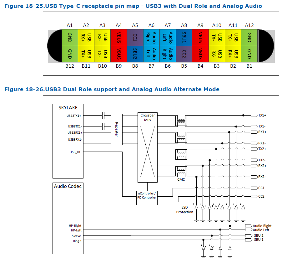

Part Number: TUSB320
Hi Sirs,
Sorry to bother you.
We want to design USB3.0 OTG,
Will it be necessary to match a chip like TUSB320 like USB2.0??
If yes, have part number can share ?
If no, have other way to design?

To clarify the OTG function is associated with changing the roles (Host to Device or Device to Host) of the USB 2.0 communication (D+, D-) not USB 3.x communication (SSTX, SSRX). Figure 18-26 mentions in the title the dual role nature of the USB port, I believe this refers to configuring the USB port as a DRP port. TUSB320 does support the ID function necessary for OTG and Type-C DRP negotiation.
